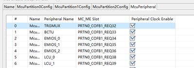

Since the BLDC example is configured by EB tresos, but I only know a little about S32CT, I do the configuration with S32CT Refer to EB project, I also learn from some other examples. But I don't know if I finished the Icu configuration correctly and if it's the reason why I can not get period data.
Here is my configuration file, and I finished the following configuration :

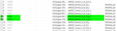

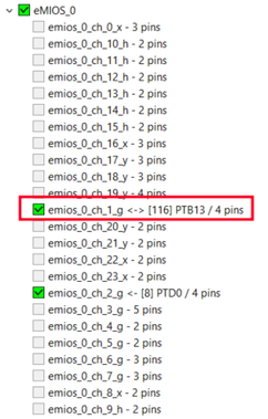

1. Set PTE11 and PTD0 to eMios in Pins setting.

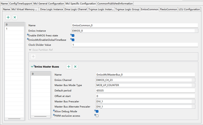

2. Set eMios MasterCounter in Mcl setting:
3. Enable peripheral clock of eMios0 in Mcu setting.

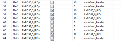

4. Enable relating eMios interrupt controller in Platform setting

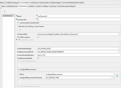

5. Set Icu channels

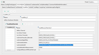

5.1 Set Icu_channel0, using eMios0_channel1, using SiganlMeasurement mode, and set to Period_Time measurement function.
5.2 Set IcueMios, using using eMios0_channel1, using MasterCounter0(eMios0_23), using IcuSubModeforMeasurement IPWM

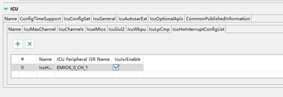

5.3 Enable eMios IcuHwlnterruptConfigList

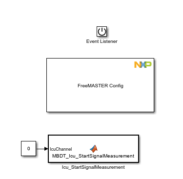

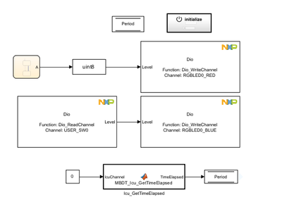

I think I have finished all related settings. Then I make a simple model to get PWM period, the model is post as follow.

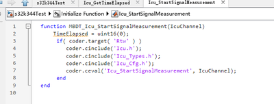

In the initialize function, I configured FreeMaster and called Icu_StartSignalMeasurement function to enable Icuchannel0.
In the main function, I set a flashing LED to ensure the program is running successfully.

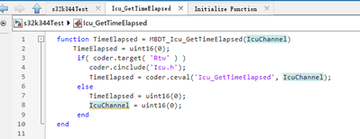

Then I used the Icu_getTimeElapsed() function which is copied from the BLDC example.
The program can be downloaded to the board and the LED is flashing as wish. However, the period data keeps zero when I give PTE11 a 3V 1kHz PWM signal, which means the Icu_getTimeElapsed() function gets nothing returned.

After investigating over your model and its associated configuration, I've included an example version that illustrates the ICU functionality.
It came to my attention that you were attempting to use the PTE11 pin, which is designated as DNP (Do Not Populate) in the schematic datasheet. Taking this into account, I've switched from PTE11 (EMIOS_0_CH_1) to PTB13 (EMIOS_0_CH_1). The Pins tool for the EMIOS_0_CH_1 instance was the only modification, as it was the same eMIOS instance for both pins.
It's also important to note that the Icu_GetTimeElapsed function returns an Icu_ValueType data type, which is an uint32. According to your model, this output was set to uint16.
Considering these suggestions, you'll be able to integrate the Icu_GetTimeElapsed functionality into your application.
It should be noted that in the attached model, the signal was generated by USER_SW0 (PTB26). Therefore, in order to measure the period, you need to connect the PTB13 (J2.4), the ICU channel that is set to Signal Measurement mode, Period Time setting, and the PTB26 (J3.3), which is the generated signal, in this case USER_SW0. For the purpose of visualizing the measure time and confirming that the implementation is accurate, I also included a FreeMaster file (s32k344Test.pmpx).
I hope you can accomplish your goal using this approach. Please let us know if you require any more information.
Dragos

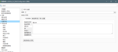

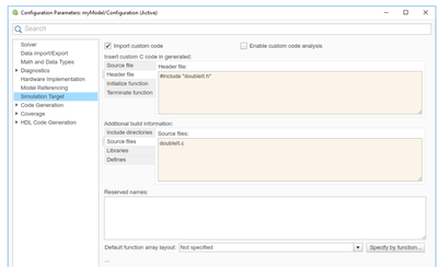

I was told to use Matlab function or C function in Simulink should set the used head file and source file in "Model configuration - Simulation target", like this:
However, I found that the example "s32k3xx_mc_bldc" didn't set these files, directly using the Matlab function to call C functions. Does it mean that this operation is not necessary?
