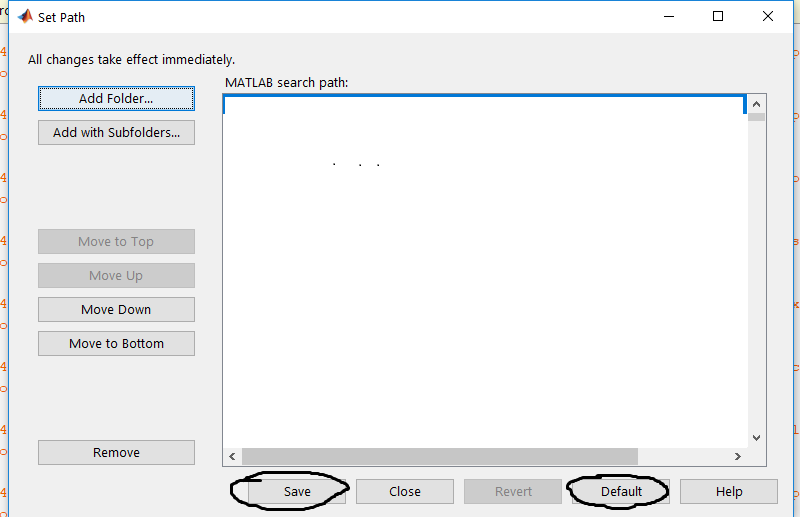

I'have installed:
Model-Based Design Toolbox for S32K14x Automotive MCU 2018.R1
and
MC Development Toolbox for Kinetis
In matlab command window, i have the following Warning. Could you please tel me how i can resolve this issue
Warning: Incorrect internal Simulink identifiers were detected. The following blocks have
conflicting identifiers:
'mcd_kv_ec_toolbox/KV5xF/Math and Motor Control Library'
'mcd_kv_ec_toolbox/KV3xF/Math and Motor Control Library'.
The Simulink identifier of 'mcd_kv_ec_toolbox/KV5xF/Math and Motor Control Library' was
changed from '65' to '91'. Backup the original model, and then save and reopen the current
model.

m_benderradji
I have done the requested step but the issue still exsist.
First, i have setted the default path and next applied teh mbd_s32k_path to add MBDT for S32
I had:
MBD Toolbox path prepended.
Successful.
Secondly, i have applied mcd_kv_path to add MC toolbox for kentis
I had:
Treating 'C:\MCToolbox\mctbx_Kinetis' as MCD Toolbox installation root.
MCD Toolbox path prepended.
Successful.
by typin ver I had:
Model-Based Design Toolbox for S32K1xx Series         Version 2018.R1     (R2016b-R2018a)
Motor Control Development Toolbox for Kinetis              Version 1.4         (R2014a-R2015b)
When i refrech the simulink librery i had the issue:
Warning: Incorrect internal Simulink identifiers were detected. The following blocks have conflicting identifiers:
The Simulink identifier of 'mcd_kv_ec_toolbox/KV5xF/Math and Motor Control Library' was changed from '65' to '91'. Backup the original model, and then save and reopen the current model.

constantinrazva
Hello m.benderradji@outlook.fr‌,
Can you try and reset the MATLAB path? For that you should go to MATLAB Home tab -> Set Path -> Click on Default -> Then click on Save.
and then run the mbd_s32k_path script so you install the path for the toolbox over a fresh, default MATLAB path.
Note: you will lose other paths other than the default + S32K toolbox paths by doing this. Consider saving the current  contents of your MATLAB path (you can get it by typing matlabpath in the MATLAB terminal for instance).
Note: this file is located in {INSTALL_ROOT}/src.
