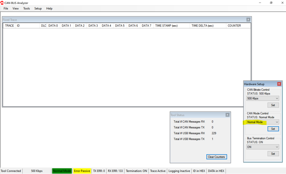

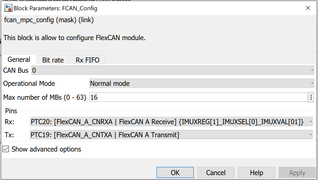

I am trying to check CAN communication on MPC5775B BMS Plus VCU Reference Design board with using MBDT. To check CAN message transmitting function I have used flexcan_master_mpc574x model after changing MCU, FCAN configuration and Digital output configuration:
After building code and flashing MCU, I have used Microchip CAN BUS Analyzer Tool
 to check output messages, but saw nothing and LED D45 is always ON. Then I have tried to check CAN receiving with flexcan_slave_mpc574x model by using same modifications, but result was same: I am not able to send any message to MCU and LED D45 is always ON.
Before I have checked both flexcan_master_mpc574x and flexcan_slave_mpc574x models with using DEVKIT MPC5744P and Microchip CAN BUS Analyzer Tool and everything was working fine.

Hi @sonik82 ,
Can you uncheck Bitrate to time segments option, increment the Phase1 segment from 5 to 6, and try to run the example again?
You should have the following settings:
Paul

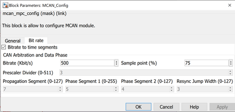

I tried the example mcan_fd_echo_mpc577x.mdl on my side, on the X-MPC5775E/B-EVB board because I don't have access to a MPC5775B BMS Plus VCU Reference Design board, and it works as expected.
Can you post a screenshot with the bitrate configuration in the MCAN_Config block and another one with the one from your CAN BUS Analyzer tool?

sonik82
Hello @paulvlase
Microchip CAN BUS analyzer does not support CAN FD, so I have used mcan_master_mpc577x model

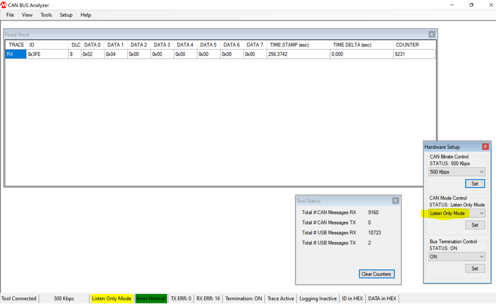

In Normal mode there is nothing in CAN analyzer
If I change mode to "Listen only", then I can see this data, which is not same with data in simulink model
Denis

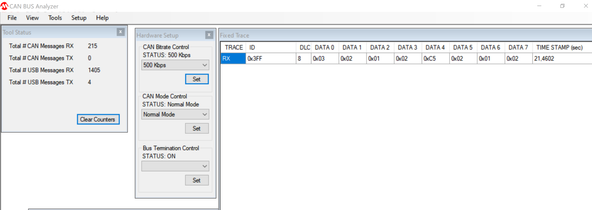

paulvlase
Hi @sonik82 ,
Paul
6,721 Views
sonik82
@paulvlase  It works. Thank you for help.

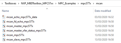

sonik82
@mariuslucianand Also I am going to try these example models instead of modification of mpc5744p model.
Earlier I didn't know about existing of these models because they are not shown in my Simulink library.

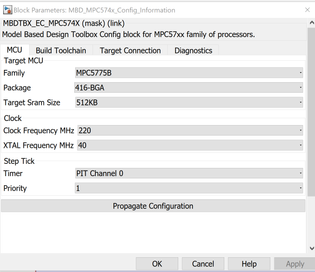

sonik82
@mariuslucianand Thank you very much for reply. I have already used this patch, without it I was not able to generate and compile a code. Also I have tried to use both CAN channels with same result. Initially I thought that issue is in Microchip CAN analyzer, but with mpc5744p EVB it works fine.
Moreover, I changed the CAN Engine Clock Source to Oscillator Clock in the FCAN config block and changed target to mpc5777C, but it also did not work.
