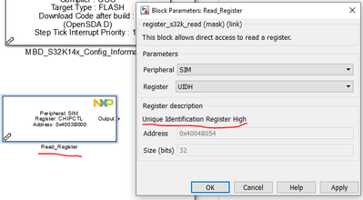

I think you can try using the Read Register block and accessing the SIM -> UIDH, UIMH, UIML and UIDL.
Hope this helps,
Marius

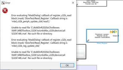

I get this error when trying to put a read register block in my model, am I missing something obvious?
Also, Is there a way to do a device reset from software? I am looking at ways to flash with the CAN bootloader and using a reset switch isn't ideal (8 boards on same bus and supply so can't just power cycle). So a way of resetting the device through software would be perfect.

Hello @Poley ,
I've seen that error before but I was unable to solve it because I cannot reproduce it on my end.
Regarding reading the UID, the other way s to use Data Read Mem block and type the direct address of the registers. Please see the attached example.

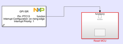

So it looks like if I use the reset function you have:
It looks like I can just change the GPI ISR to a CAN signal that when set to 1 triggers the subsystem containing the reset MCU matlab function, should this reset me all the way to the bootloader code? (Currently just using OpenSDA).

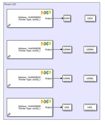

Also for UID do I need to read all 4 registers?:
How do I get a single value I can put onto CAN? or is that value too large?
