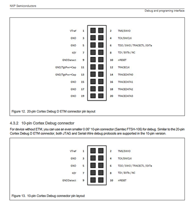

Hi all,
I am currently designing a new board and will want to carry out PIL testing from the simulink blockset but there is multiple versions of JTAG pins. Do I need to have a certain configuration? I am using a S32K144 and the evaluation board for that shows a 10 pin version but the S32K148 EVB shows a 20 pin version. What one do I need to be able to run PIL and external mode through a JTAG device? Obviously 10 pin is preferable for less tracks and pins.
Thanks!
