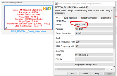

I have a model that contains FCAN blocks. The Simulink build fails when “Target MCU > Family” is set to “MPC5775B” in the configuration block. However, the build is successful when “Target MCU > Family” is set to “MPC5777C” in the configuration block. That is strange because the MPC5775B is the actual chip on the dev board. Why does the build fail?

@paulvlaseWith the target set as MPC5775B, I changed the CAN Engine Clock Source to Oscillator Clock in the FCAN config block and tried again. Now the code worked as it should.

@mariuslucianand I followed your instructions above. I set the target to MPC5775B. The build completed without errors. The code was downloaded to the board. However, the code did not run properly: Some LEDs that should have been flashing did not. A CAN message that should have been transmitted was not.
I set the target back to MPC5777C and replaced the new file with the original one and built and downloaded again. The code ran as expected.
Apparently the fix did not work as expected.

Hi @ranulf , @iraleksandrova1 ,
The input muxing configuration for FlexCAN RX is not correct.
Can you try to apply the attached patch?
The steps to do that are:
1. Download the attached zip file and unzip it.
2. Run mbd_find_mpc_root() to get the root folder there the MPC57xx toolbox is installed.
3. Open the mpc5775b_e_flexcan_patch.exe file and extract it's contents to the root folder.
4. Try again your model.

I ran mbd_find_mpc_root() in the Matlab command window to get the path:  C:\Users\[user]\AppData\Roaming\MathWorks\MATLAB Add-Ons\Toolboxes\NXP_MBDToolbox_MPC57xx.
I put  mpc5775b_e_flexcan_patch.exe in that location and ran it. When the Confirm File Replace window opened I selected the Yes to All option.
In my model in the MBDTBX_EC_MPC574X Config_Information block I changed Family to MPC5775B. I built the code and downloaded to the eval board. The build proceeded without errors. However, when I ran the code the board was unresponsive.
I changed Family back to MCP5775C and rebuilt and the code appeared to work normally again.

I confirm that this is a bug. So let's try fixing it by replacing this p file under {MPC installation folder}\mbdtbx_mpc\mscripts\fcan
Once you tested this, please let me know if the error is gone and the CAN works.
