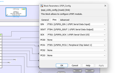

mariuslucianand
Hello @PRAtyay1231,
From what I see in the attached image, you are using the MC33772C via SPI and therefore the example targeting MC33772B might not work.
MBDT for S32K1 does not provide a ready to run example for this combination of S32K144 and MC33772C via SPI in the toolbox, but, we offer the bms_s32k_mc33771c_spi which comes with the settings for the closest related part.
I would suggest you to start for the bms_s32k_mc33771c_spi example and apply the following checklist:
1. Open the LPSPU Config block and check the list of pins from the Pins tab to be the ones assigned on the MC33772C SPI board.
2. Open the MC3377xC Config and change the device from MC33771C to MC33772C. If there is a different CS pin for SPI, please adjust this in the SPI tab and then go to the Pins tab to make sure that the RESET_ALT0 is the same one routed on the RESET Pin on the MC33772C evaluation board.
Let;s apply the settings above and then try to see if the MC33772C responds over the SPI protocol as desired.
Please make sure you keep the right binaries and GUI tools for the MC33772C.
Then, as Tomas suggested, please recheck the wiring of your setup according to the MC33772C Reference Manual.
Hope this helps,
Marius

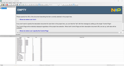

Hello @PRAtyay1231 ,
I am glad you are now communicating with the board from the generated code in Simulink!

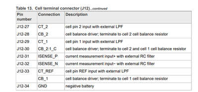

From what I see, the results you get in FreeMASTER from the generated code are the same with the ones from the GUI. Therefore my assumption is now related more to the hardware connections you did. Please check the wiring.
The J12-34 with the J12-33 and the J12-31 are required to be connected to the GND of the Battery Pack (NEG of the Cell 0).
The J2-1 and J2-19 needs both to be connected to the Positive  off Cell 5 (POS of the Battery Pack).
Hope this helps,
Marius

PRAtyay1231
All three pin need to connect with ground? I connect only J12-34 GND of the Battery Pack (NEG of the Cell 0).
1,731 次查看
PRAtyay1231
Dear @mariuslucianand
Now The J12-34 with the J12-33 to ground I could able to see all 6 cell voltage. but still unable to see pack voltage.
for getting Pack voltage what to do?
Pratyay

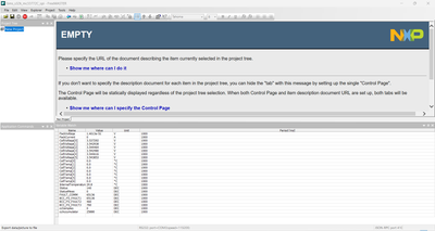

mariuslucianand
Hello @PRAtyay1231
I am glad it worked!
I think for the PackVoltage is only an issue on how FreeMASTER is configured to display that value.
In FreeMASTER if you double click on the Pack Voltage check to see what is the type of Variable and the Real Type Transformation. Please have some play with the FreeMASTER settings. If still not working, please check  the data types in Simulink, in the Generated Code and on FreeMASTER.
Marius

1,603 次查看
PRAtyay1231
dear @mariuslucianand ,
Now it looks working. Thank you for your support.

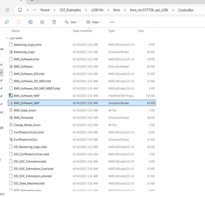

Dear NXP Team,
I am flashing the below model in s32k144 but its unable to read data *Voltage/Temperature)using the MBDT tool. Why I am unable to read data? Is there any license required?
Please let me know the steps to deploy this package.
C:\Users\user\Downloads\MBDToolbox_S32K1xx_4.2.0_20200720 (1)\fsroot\S32_Examples\s32k14x\bms\bms_mc33772b_spi_s32k

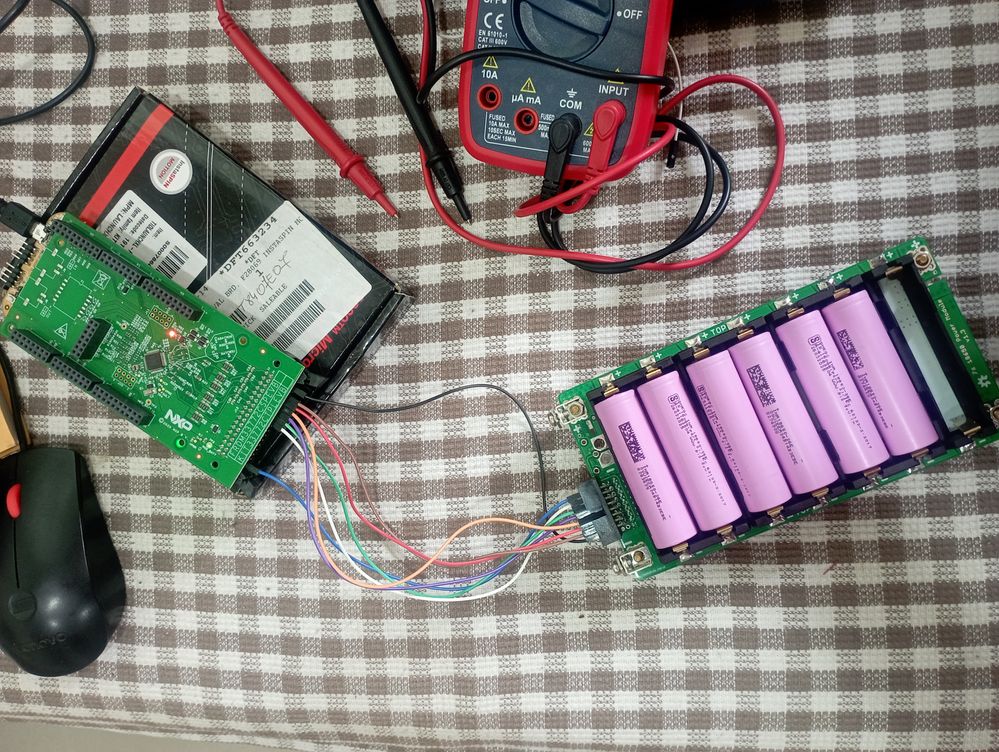

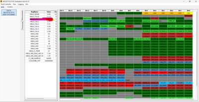

1,991 次查看

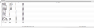

PRAtyay1231
Dear NXP Team,
Now, I was able to connect MC33772B Evaluation GUI and see the voltage but I am getting some issues, although I am giving 6 voltage for 6 cells only for 2-5 cell voltage able to see that cell one voltage getting zero (initially some voltage was shone for Cell 1 but after sometime its became zero.MC33772B board I could See voltage going to the U1 microcontroller.
Please suggest to me what is the issue and how I can fix it1749964429970.jpg1.png.
1,940 次查看
TomasVaverka
Dear Pratyay,
Use a multimeter to directly measure the voltage across Cell 1. If the voltage is present at the battery, but not on the board, the issue is likely in the wiring or board input. A loose or broken wire could cause intermittent or zero voltage readings.
BRs, Tomas
1,930 次查看
PRAtyay1231
Dear Tomas,
I have checked Bellow steps,
1. Checked the Battery output voltage (which was correct near to 3.5 Volts)
2. Check the voltage is going to MC33772B board was going or not ( It was ok and expected voltage was going to controller)
observation: once start the observation , cell 1 voltage start display from 2.6 volt and gradually decrease to Zero.
Please help with Further Step.
