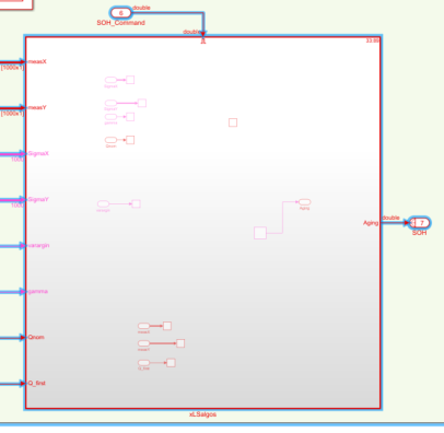

Dear All,
I have a subsystem in my model. When I disable (by Cont+Shift+X)  it my model works great and I can get all CAN messages. But when I enable I can not get any CAN messages despite of that model has nothing related with CAN in itself.
To be able to debug the problem I deleted all inner subsytems and only terminators remain. But still it does not operate. What may be the problem?
Thanks.
Figure 1. Model
Figure 2. Inner part of model (most of them is deleted)

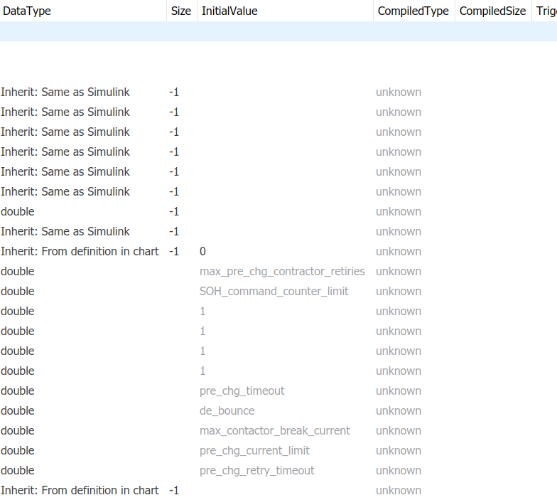

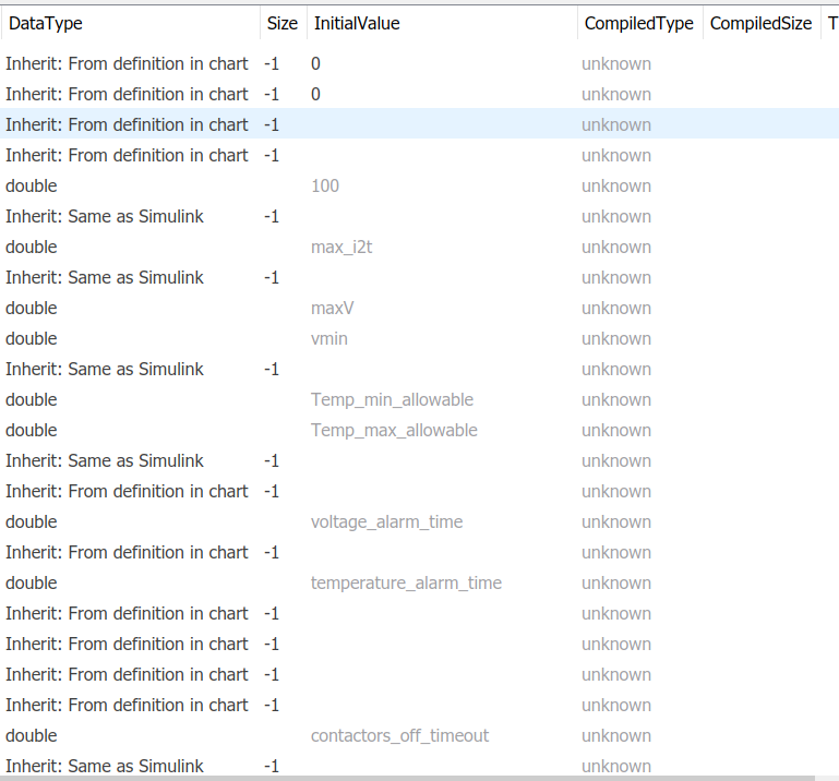

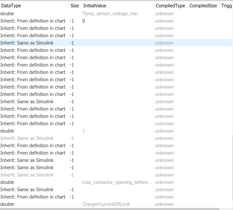

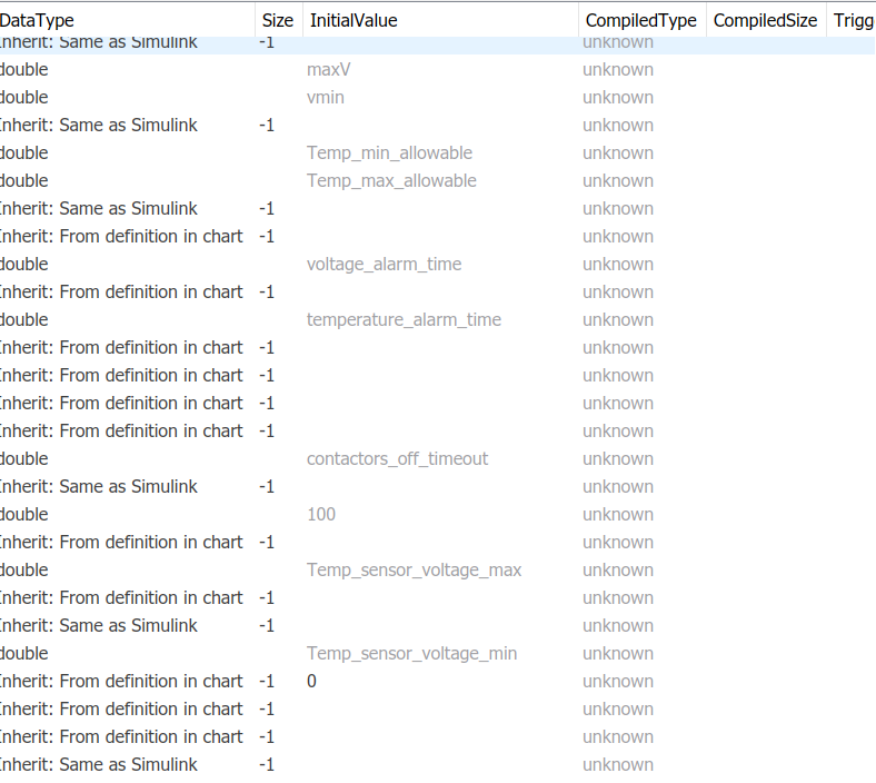

ykarata1
Dear All,
Also I am trying to add state diagram to my system. When I add it also stops working. Do you sene anything wrong on images below?
Thanks.
Thanks in advance.
