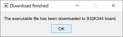

the Application Download to the S32K3x4-Q172 DevKit from Simulink failes with an Error.
After that error it reports that the Download was successful but it does not work.

It looks like you are using the MBDT for S32K3 (version 1.1.0) and you found the problem caused by the Windows limitation regarding the path maximum length of 248.
The latest MBDT for S32K3 release (version 1.2.0) includes a fix for the misleading successfully download message. Now an error message appears when the executable file cannot be found.

I found the problem.
The GDB-Server couldn't load the .arp file for the chip because the path was longer than 248 characters (**bleep** you Windows).
CMD>CM C:\Users\mdenzinger_lokal\AppData\Roaming\MathWorks\MATLAB Add-Ons\Toolboxes\NXP_MBDToolbox_S32K3xx\tools\eclipse\plugins\com.pemicro.debug.gdbjtag.pne_5.1.4.202109291837\win32\gdi\P&E\supportFiles_ARM\NXP\S32K3xx\nxp_s32k344_1x32x1012k_hse_disabl▒
.ARP file does not exist.
Error loading programming algorithm - load aborted.
Error occured during Flash programming.
Most users probably won't have this issue because theis username is shorter (It's only 5 characters to long).
The workaround for me is to change the MATLAB Add-Ons Folder.
