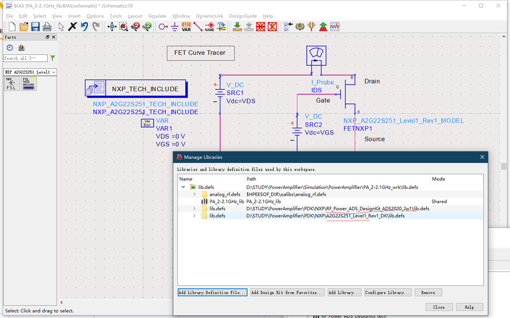

I have a problem when I simulated in ADS2020 (Advanced Design System 2020).
When I started simulating with the model"A2G22S251_01S_MDL_ADS", the hpeesofsim had an error: "G50v3_4_lib_CG50v3-3_HEMT_r1_schematic.mikel' is an instance of an undefined model 'Cree_NL_GaN_HEMT ' ".
I have check some similar questions in the form.However, I have add both "A2G22S251_01S_MDL_ADS" and "RF-POWER-ADS2020v2p1-DK" to the library.
When use a diffrent model except "A2G22S251_01S", like"MRF6V2300N", "AFT20P060_4N", there was not the error and it simulates normally.
So I guess there is some problem with model "A2G22S251_01S"

here you can see how I solve this error. I hope it helps you:
https://www.youtube.com/watch?v=UrvMeU0AwM4

I am also finding the same issue, just wanted to know is your problem resolved now??
