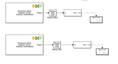

You can configure two ADC channel, but you need to assign them to separate groups:
  In the interrupt handler, you can check the channel group register to see if conversion is done and read the converted value:
But you must configure the ADC channel assigned to group1 to be triggered by hardware event - software trigger is supported only on group 0 (you can see the information also in MCUX configuration tool as a tooltip in group selection for the channel but also in the processor reference manual).
You can try also to use the same conversion group for both channels with continuous conversion unchecked in the MCUX Configuration Tool file, and software trigger the conversion from Simulink alternatively on each channel (or at a user button press) by using the ADC Start Block. And in the ADC interrupt handler you add just one ADC Read block - will not matter what selection of the channel you do there, since the read on done on the conversion group and not on the channel (we need to rethink that block for the next release).

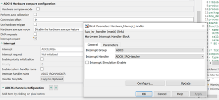

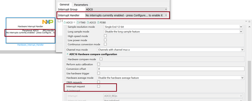

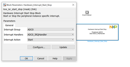

First, the Hardware Interrupt blocks is telling that there is no interrupt enabled in the .mex file for the ADC peripheral. It also telling that the user should use the Configure button to open the .mex file in MCUXpresso Configuration Tool and enable the ADC interrupts.
If you check the Interrupt request in Configuration Tool (ctrl+S to save the change) and then Update in the Interrupt Handler block you'll see the name of the ADC interrupt handler:
Same applies for the Start/Stop Hardware Interrupt block:
Because in the .mex file, Interrupt request is set to Not initialized:
Then you need to add the Start/Stop Hardware Interrupt block to insert the code that enables the ADC0_IRQn interrupt. (EnableIRQ call). The alternative of this block is to choose the Enabled in Initialization, that will insert the peripherals.c, in ADC0_init the EnableIRQ call and so you'll not need to use the ISR start stop block.

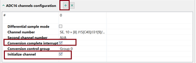

The next step, is to configure and ADC channel in the .mex file:
Use the + button to add an ADC channel, select the channel number on which the conversion will happen, enable the interrupt on the channel and also initialize the channel. For channel number, the selection, the tool provides a drop-down with the pins that were set in the pins view for the ADC0 peripheral:

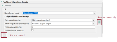

As for the FTM configuration, if no channels are being set then the FTM will act as a simple timer. To use it for input capture/dual edge capture, pwm generation you must add and configure the FTM channels:
In order to use the FTM update duty cycle block, you must configure at least one FTM channel for PWM generation. Also for FTM you can take a look at the examples from the toolbox.

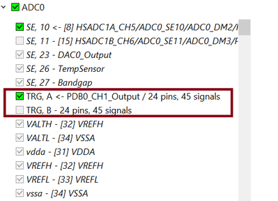

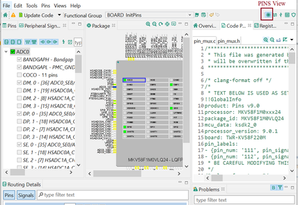

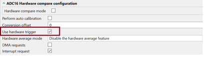

 In our ADC examples, the conversion is triggered by software. For hardware trigger, the Use Hardware Trigger must be enabled in the .mex file:
And you must configure at lease one of the trigger pins in the Pins view:

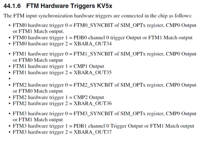

I've looked into the manual for KV5x and it mentions that the ADC can be triggered by the PDB:
And the FTM can trigger the PDB:
