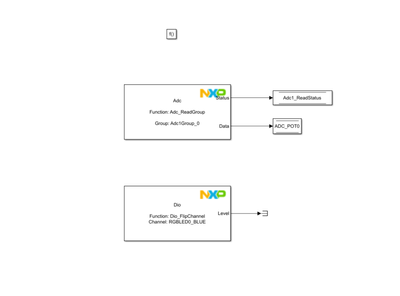

i'm trying the adc conversion with hw trigger on S32K3X8EVB-Q289.
For this example i've configued:
PTF21 as PWM(eMIOS)
PTA11 as ADC
I've also configured an ADC group with conversion type injected and hw trigger signal RISING EDGE
in the model i've put a filp led block inside the adc interrupt callback which toggle the led1_blue of the board each time a coversion is completed.
The behavior which i don't understand is that whether i configure the hw trigger signal as RISING or FALLING edge, on my oscilloscope i see that the led is always toggled on the FALLING edge...
Why is this happening? could someone help me with that?
