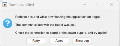

I just purchased a S32K3X4EVB-T172 EVal board. I tried to run the example "code s32k3xx_dio_s32ct". It compiles correctly, though, can't load into the board. The same board I could make it work with a simiular example directly from NXP DS.
I also changed the Hardware part to "S32K344-Q172". It is the same. It gives the error "Runtime error 216 at 6BEBA7AE". Then the following message:
And this log:

Remote communication error. Target disconnected.: Not a directory."
Could you please help me what is wrong, and how I can make it right?

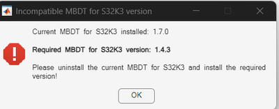

I have installed MATLAB R2025a with add on 1.7, and MATLAB R2024b with add on 1.4.
If I try to open any MATLAB NXP example with MATLAB 2025a, add-on 1.7, I get the following error.
Actually, if I just ignore this and continue running the code, it will compile, and even load into the MCU and run correctly!
Could you please clarify with this? Can we focus on resolving this? For now, I will continue using the embedded coder with this alarm until we find what is going on.

SorinIBancila
The error you get is due to the fact that MBD Toolbox for BMS is working only with MBD Toolbox for S32K3 1.4.x version. It is not compatible with S32K3 1.7.0 version.
To solve that error, you can do the following:
1. Do a backup of the modified examples (if any) from the toolbox.
2. Uninstall all toolboxes, on both MATLAB R2025a and MATLAB R2024b.
3. Modify the addons default installation path for each MATLAB version you have installed. Please use a short name and without whitespaces. It must be unique for each MATLAB version you have.
e.g.: MATLAB R2024b default path : "C:\MATLAB\Addons\Toolboxes\R2024b"
MATLAB R2025a default path: "C:\MATLAB\Addons\Toolboxes\R2025a".
To change the default installation folder follow these instruction:
4. Install again the NXP MBD Toolboxes you need for each MATLAB version.
In your case, the problem is that both MATLAB version have the same installation folder and even though you installed a toolbox in a R2024b, it is also available in R2025a. The S32K3 1.4.x checks for other S32K3 toolboxes and it detects that the 1.70 is installed, hence the error.
Let me know if this solution fixes your problem.
Sorin Bancila

alimaknouni
Hi Sorina,
Thanks for your explanations.
Actually, in the beginning I only installed MATLAB R2025a, and Add-on Ver 1.7. Though, it was giving the compatibility issue.
Therefore, I'm not sure if re-installing add-ons would solve this problem.
Is there any other way to resolve this?
