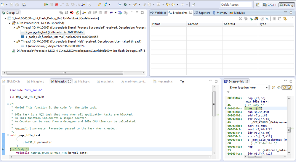

I am using my own board based on MK60DN512VLL10,(use 50 MHZ external osc) the board can run projects without MQX.
I have cloned Board Support Packages based on TWRK60D100M, and use PE to change the MCU and clock settings, change the pins for the peripherals and GPIO, but the MQX still can't run on my board,
I want to know what else do I need to do to built my own MQX which can run on my board.
the picture below show the return message after i run the MQX  project , i think this will help you to find the problem.

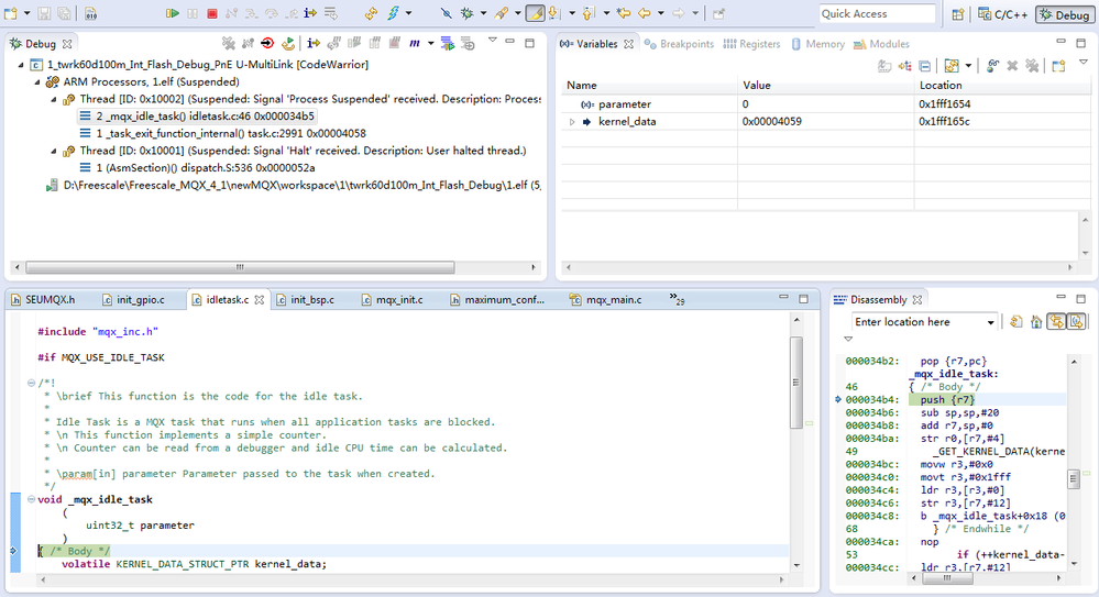

Hello botao yang,
Are you using breakpoints?? Which MQX version are you using???
The Debugger will consider BreakPoint as a trap or exception when debugging. Since user's task has higher priority than the system (MQX) idle task. When there is a breakpoint in user's task, the CPU (CPU core of target MCU) will stop the current task at the breakpoint place and then let the debugger to handle this breakpoint issue. As you know, MQX is a multi-task system, during the time period the debugger preparing the breakpoint issue, the CPU loaded the idle task to execute and then got the "stop" instruction from Debugger and then stop there.That is why Debugger stops at the entry point of idle task.If resume the application, the Debugger will then stops at the breakpoint which was set before.

The MQX project is a basic example project which I haven't make any change, also in the Breakpoint there is no breakpoint as you said, If you are right, how to remove the breakpoint?
