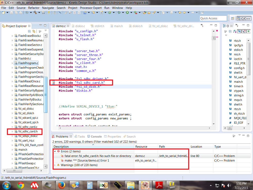

I tried to add FATFS files into my project but am getting following error. i dnt know why?
i added image here.,
1,605 Views
sudhakarp
Contributor V
hi,
i solved "no such file or directory problem". and i initialized Sd card SPI pins
