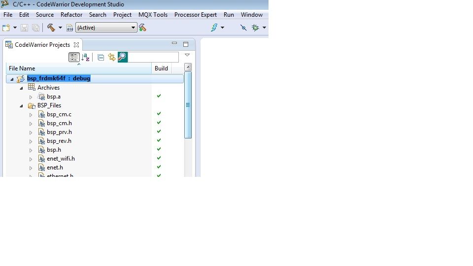

danielchen
HI
I compiled the bsp library successfully according to your steps. Could you double check it or try other demos?

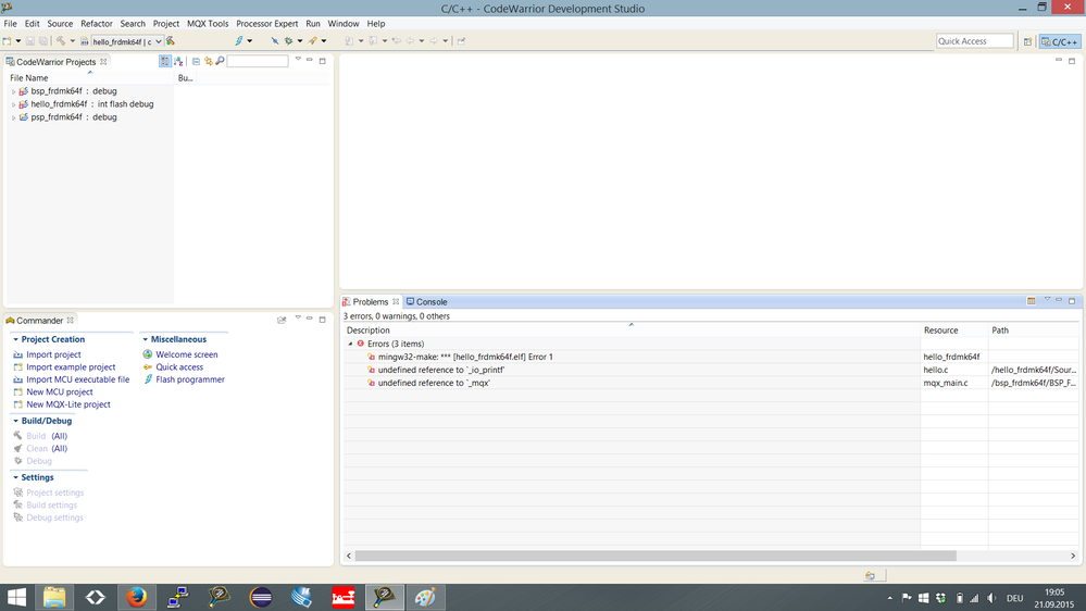

niklasroth
Hi Daniel,
Thanks for response. You can find the errors below. I actually tried it even on an other pc with windows 7 and there it was just the same problem.
Additionaly I tried it with the Hello2 and GPIO example project and it happens just the same. These Projects work for other hardware but for the frdm-k64f!!

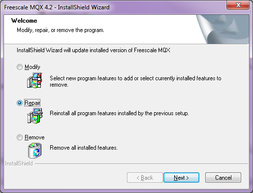

soledad
Hello Nik,
MQX contains libraries BSP, PSP, Shell, USB, MFS, MCC, FFS, these libraries provide support for some applications. In your case you only need to build the BSP and PSP libraries, however it is necessary to build the libraries before to build the demo application or MQX example code.
As Daniel mention maybe there is some wrong in the k64 files, another solution is to run the MQX installer and select the option repair. After that please import again the .wsd file build the libraries and build the example.
Have a nice day!
Sol
4,364 Views
niklasroth
Hi Sol
Thank you for replying. Repairing it didn't remove the problem. Eventually I reinstalled bouth, the CW and MQX, which at least solved the problem on the windows 7 PC, but on the windows 8 PC. On the windows 8 system I already reinstalled it before and it didn't helped. Maybe I just do it again...
Thank you very much for your support!!

danielchen
Hi Niklas:
Can you show your error message here?
