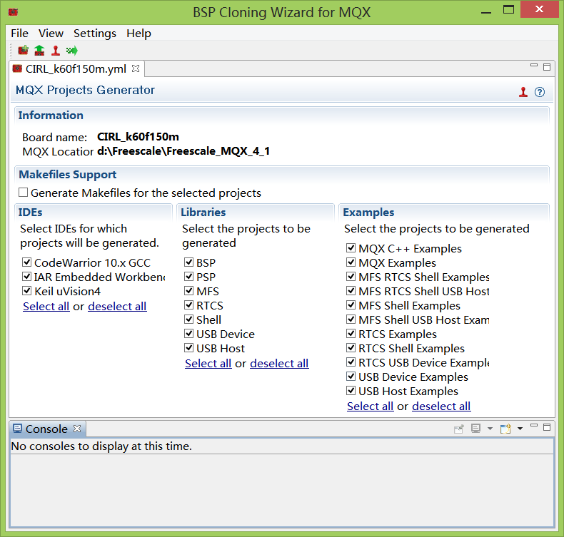

I creat a BSP clone, but at Libraries build project, it does not contain the project file.

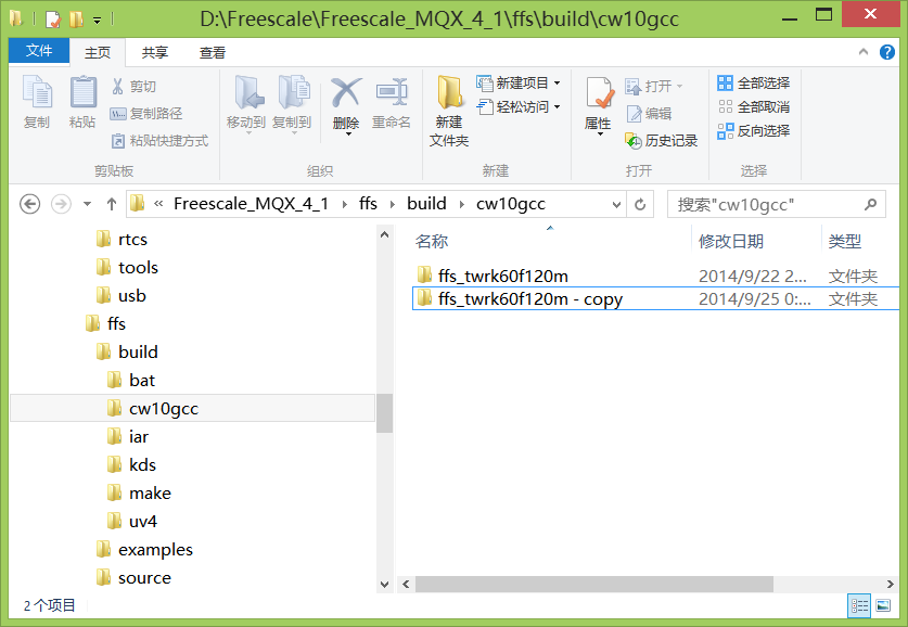

I check the filesystem, I find there are something missing:
I assume {MQX_ROOT}=D:\Freescale\Freescale_MQX_4_1 ,  {BOARD_NAME}=CIRL_k60f150m , copy from {BOARD_SOURCE}=twrk60f120m, IDE is CW10.6
In the path {MQX_ROOT}\build\{BOARD_NAME}\cw10gcc\ , the wsd file does contain the ffs project declaration, but does not have such BOARD_NAME(directory) in {MQX_ROOT}\ffs\build\cw10gcc\ .
I try to do something with this issue, and find some solution:
QQ截图20140925001516.pngCopy the directory by using the {BOARD_SOURCE} as template which you clone from, and rename it to {BOARD_NAME} , then search all sub-directories and find every file which contain the string {BOARD_SOURCE}.
Replace it ( {BOARD_SOURCE} ) to {BOARD_NAME}.
Then, when you use the CodeWarrior, using the work set import, it goes well!
I use the same method, to build my KDS project.
I referenced the guide books of MQX. Especially the MQX_User_Guide

I experienced the same issue with MQX 4.1.  The "ffs\examples" and "ffs\source" folders were copied, however the "ffs\build" directory was omitted.  I manually created the "build\iar\<board name>" folder structure, copied the reference board files, and then renamed them.  Note that I had selected to only generate the IAR projects (ARM DS-5 option was unchecked).
It was unclear to me from Zhang Jun's reply whether the MQX 4.1.1 patch fixes the ffs cloning issue.
