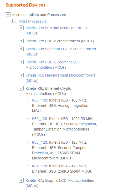

RichardR
On the MQX Classic page, MQX™ Classic Software Solutions|NXP this is the list of supported processors.  I didn't do any further digging at the time because I made the incorrect assumption that the list on the main page for MQX Classic would be correct.  I was just hoping to help other people avoid the issues I had figuring out what tools I could and could not use for the K65.

soledad
Hello Richard,
Please let me apologize if this is a little confused.
However it is possible to use MQX classic for all the Kinetis devices you can see in the list but we don’t have the BSP’s for all devices. If the BSP is not provided then it is necessary to take the closest BSB to the device used, clone it and modify the new BSP according the needs.
For example there is not a BSP for Kinetis K30-100Mhz, so it is necessary to take the twrk40d100m BSP, clone it and modify according your needs.
The BSP cloning wizard is a tool that can help to clone the BSPs. After install MQX you can find this tool at the path:
C:\Freescale\Freescale_MQX_4_2\tools\BSPCloningWizard
In addition you can find a pair of documents that show a guide to porting the MQX BSPs to the custom target hardware with a similar MCU derivative including an example of the porting.
C:\Freescale\Freescale_MQX_4_2\doc\mqx
Please complete survey to help shape the future of MQX v5.
Thank you for your feedback.

danielchen
Thanks Richard, I will inform my colleague to update this list
