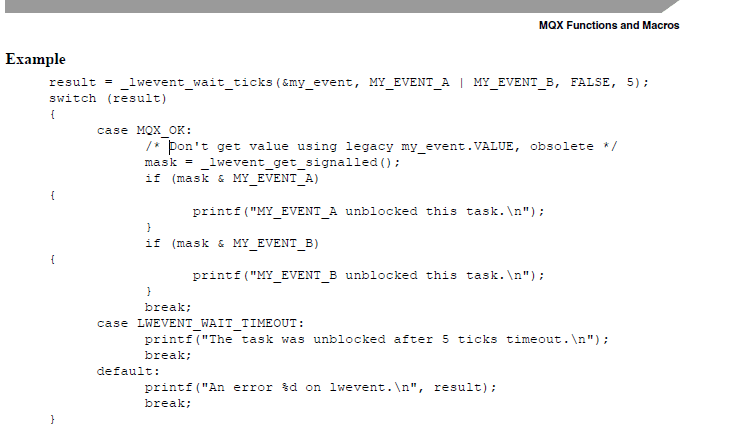

In addition to Martin's question have you re-compiled the RTOS after making the BSP_ALARM_FREQUENCY (1000)?
You can also implement the following code to check your _lwevent_wait_ticks() call with following from the MQXRM.pdf in MQX4.0\doc\mqx path:

BielikM
Can you explain to me how you measured the time? Test for this functionality has been added in 4.0.2 release and works. Can you try to measure ticks (with function _time_get_elapsed_ticks()) before and after _lwevent_wait_ticks function and call _time_diff_ticks()?
We should decide if it is problem of lwevent or mqx timing.
