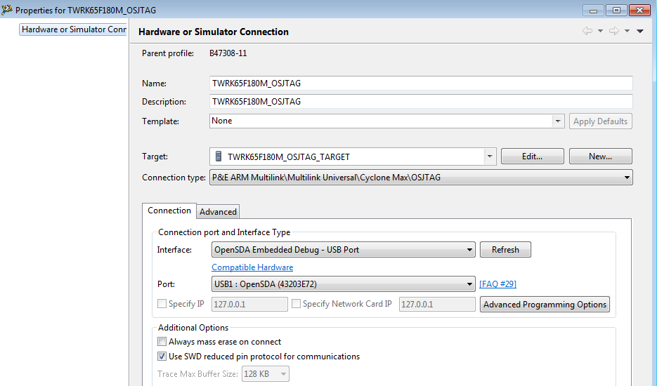

I think you need to choose connection type 'P&E ARM Multilink'. I did a quick check with codewarrior 10.6.4. it should be same as 10.7. Please check the below picture when i debug with opensda interface.
