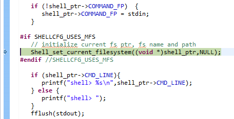

danielchen
Hi Manuel:
Sorry.
One difference ,
In your case
It sets shell_ptr->COMMAND_FP to stdin at line 76 in the beginning. Then it goes into the while on line 91.
In my side, it goes to Shell_set_current_filesystem, not line91
Maybe you need to check macro SHELLCFG_USES_MFS
