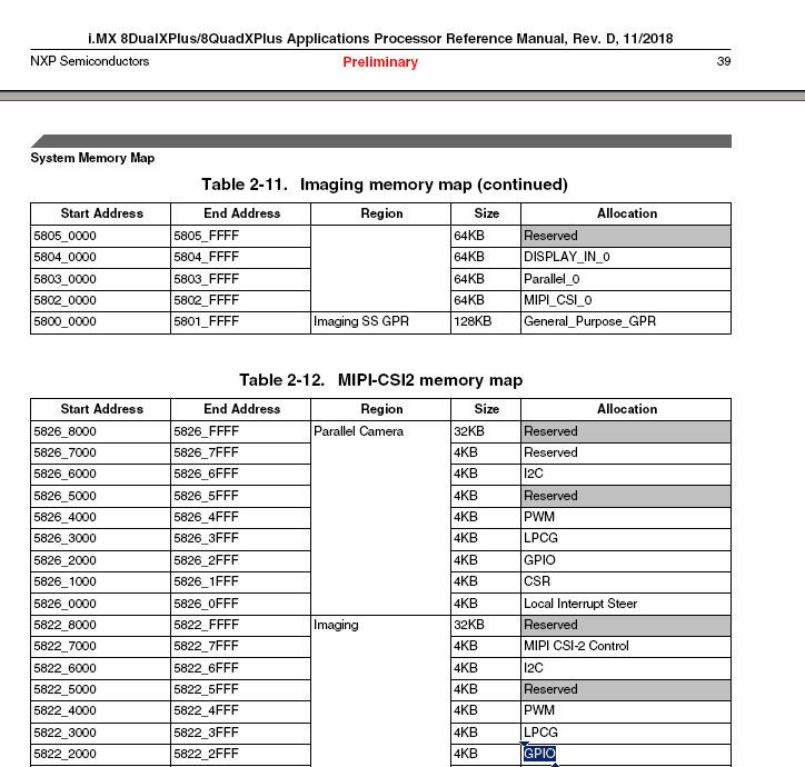

Could some one tell me what is the function of MIPI_CSI0_GPIO0_00 and MIPI_CSI0_GPIO0_01 in i.MX 8QXP? I don't understand why MIPI_CSI0_GPIO0_00 was set as MIPI_CSI0_RST, and MIPI_CSI0_GPIO0_01 was set as MIPI_CSI0_EN on MCIMX8QXP-CPU MEK schematic.

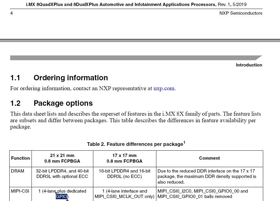

And I also saw "i.MX 8QuadXPlus and 8DualXPlus Automotive and Infotainment Applications Processors(Rev. 1).pdf" wrote that "MIPI_CSI0_I2C0, MIPI_CSI0_GPIO0_00 and MIPI_CSI0_GPIO0_01 balls removed".
I was very confused now, and I don't know if I need to set 2 GPIO output pins to these 2 pins on i.MX 8QXP. Thanks.

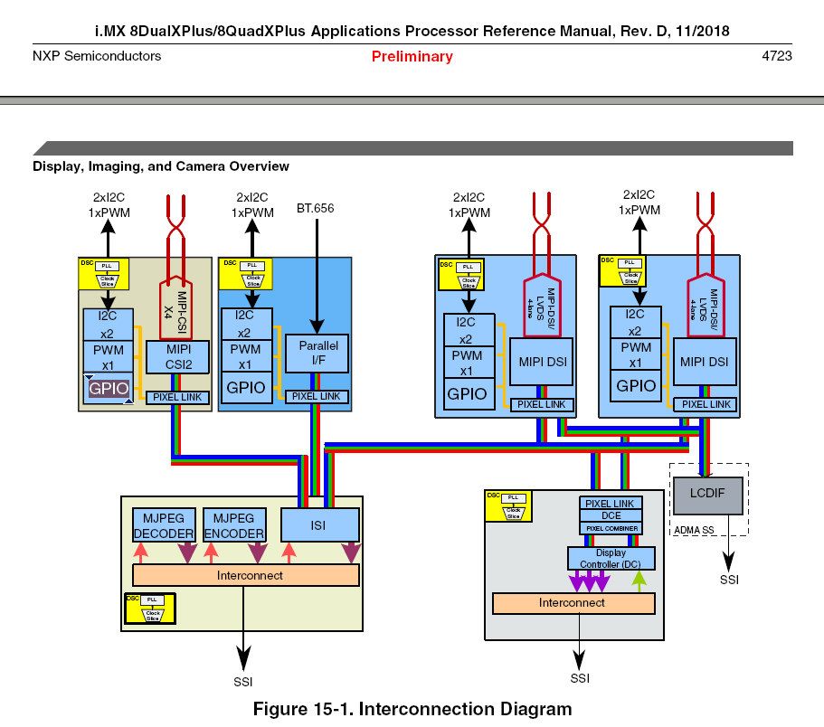

Hi Carolyn
these GPIO0_00(01) serve as usual gpios, MIPI_CSI0_RST as reset function
other as enable. These gpios are located  in MIPI-CSI subsystem and present only in
21 x 21 mm package
