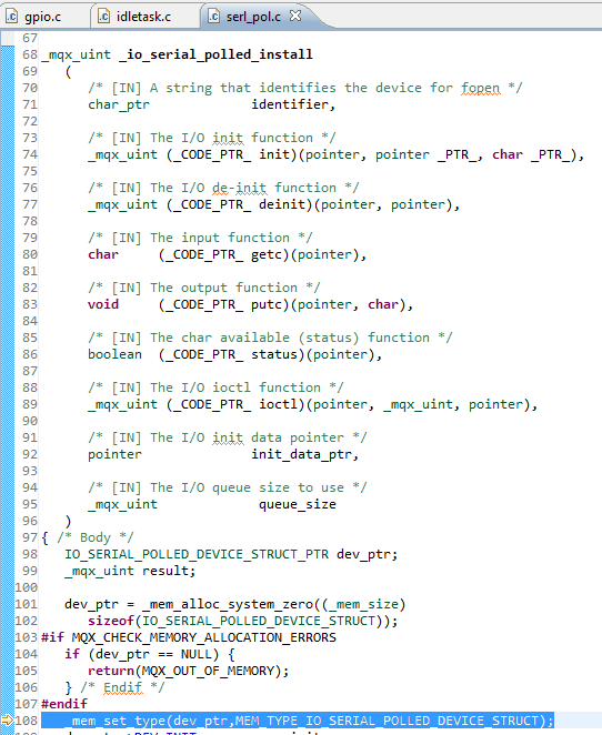

The _mem_set_type(); function call is used to identify blocks of memory with a particular driver when allocated from heap.
Example in the UART polled driver:
The MEM_TYPE_IO_SERIAL_POLLED_DEVICE_STRUCT #define is in the mqx.h header.

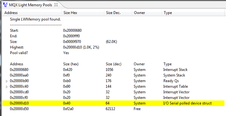

Here is a picture of the heap before the _mem_set_type() call:
Here is a picture of the heap after the _mem_set_type() call:
This allows the RTOS to be able to scan through the heap to find resources (i.e. memory) to manipulate in one fashio or another.
It is also used by the Task Aware Debugging (TAD) enabled IDE debuffer to be able to display the heap and show who owes what.  The TAD was used to generate the above two heap pictures.
