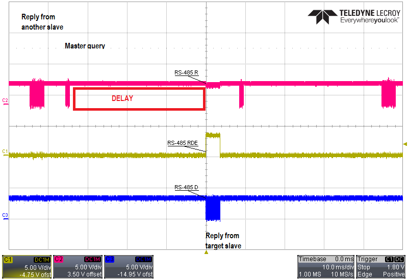

Problem:
Unnecessary delays in between Master query and Slave response
Scenario 1:
Baud 19200
Master continuously polling (round robin) to all slaves.
Result:
As you can see from the figure below, there was a delay of approximately 13ms between the master query and the slave's response. In my code, I did some processing in between but not too drastic that will cause 13ms. I tried to debug the code on the slave's side, I found out that the OnBlockReceived (Processor Expert generated) didn't fire until 9ms later after the last byte of the master query was received. Since I am on interrupt, I should be able to get the trigger from the moment I receive the first byte. However, the OnBlockReceived triggered me not only on the last byte but with an addition of 9ms delay. Hence, my code was able to process the received data only then. The figure below was captured when the master is continuously polling the slaves (I am not on debug or I didn't halt the system). The next figure and scenario below will give out further evidence on the delay.

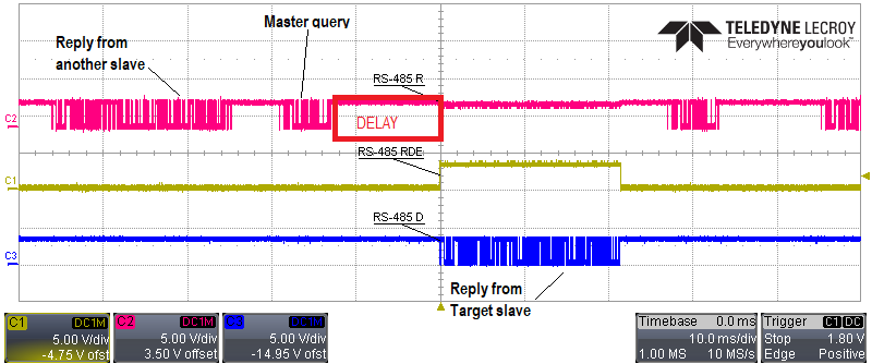

Scenario 2:
Baud 19200
Master is on debug allowing 1 step through to the target slave.
Same setup and code as Scenario 1. But instead of running the code I put a halt allowing 1 poll at a time.
Result:
As you can see from the figure below, the delay between the master query and the slave's response was shortened considerably to 4ms. This is acceptable to me. So this somehow coincides with my reading of additional 9ms delay by the late trigger of the interrupt. If you add the 2 it will end up 13ms delay.

Sorry for the late reply. I found the problem. It is actually on my code. Nothing to do with the MQX. Thanks anyway.
