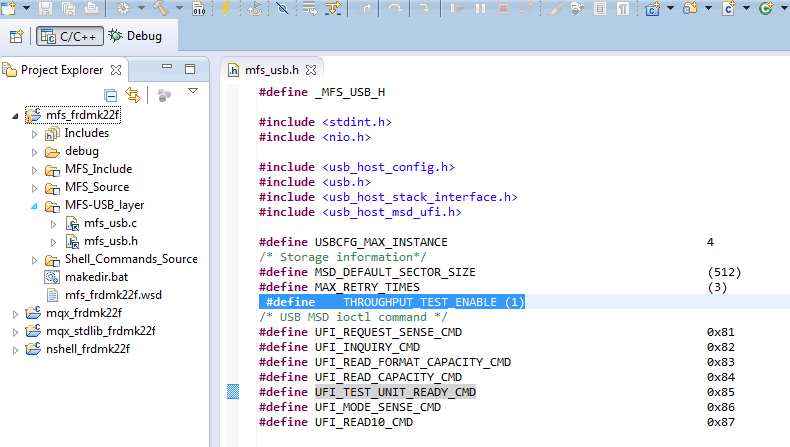

soledad
Hello David,
Are you using KDS??
If you want to test throughput, you should set THROUGHPUT_TEST_ENABLE as (1) in file mfs_usb.h for mqx, file msd_diskio.h for sdk.
For MQX, please add the below line in the  mfs_usb.h file and recompile the library.
#defineTHROUGHPUT_TEST_ENABLE (1)
Sol

davepfaltzgraff
Senior Contributor I
Hi Soledad,
Yes, I should have mentioned that I'm working in KDS. As it turns out, I was trying to do this with just the SDK so that the adapter_cfg.h had
#define OS_ADAPTER_ACTIVE_OS OS_ADAPTER_SDK
In msd_diskio.h I had changed THROUGHPUT_TEST_ENABLE to (1) as you suggested. It was under those conditions that I got the linker error message. SO, that was my original question.
When I go back to adapter_cfg.h and change the OP_ADAPTER_ACTIVE_OS to OS_ADAPTER_MQX, I get a different error that will requires separate investigation.
