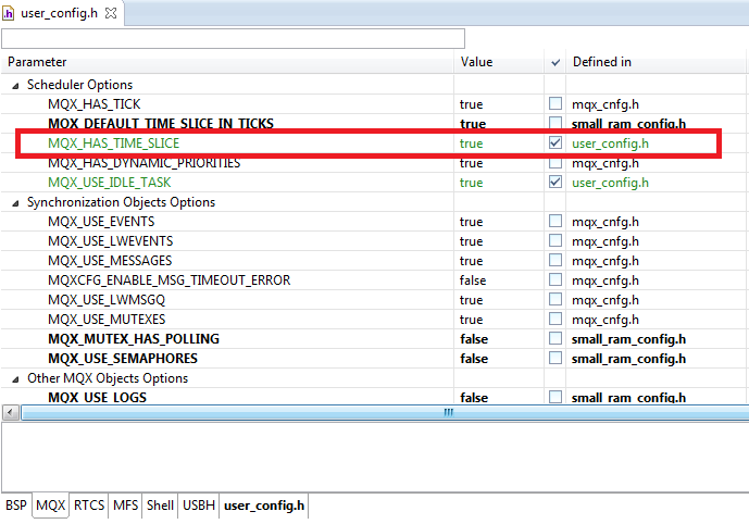

Please use the attached example. In order to use time slice you need to enabled
#define MQX_HAS_TIME_SLICE                        1
in the user_config.h.

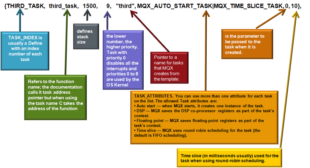

What is the meaning of The MQX_TIME_SLICE_TASK?
{THIRD_TASK,   third_task,   1500,
9,   "third", MQX_AUTO_START_TASK|MQX_TIME_SLICE_TASK,
0, 10},
Does it mean that the task " THIRD_TASK" will
be scheduled per 10ms?
If I want my task scheduled per 10ms, how should I do?
1,242 Views
soledad
Yes, the task will be scheduled per 10ms.
