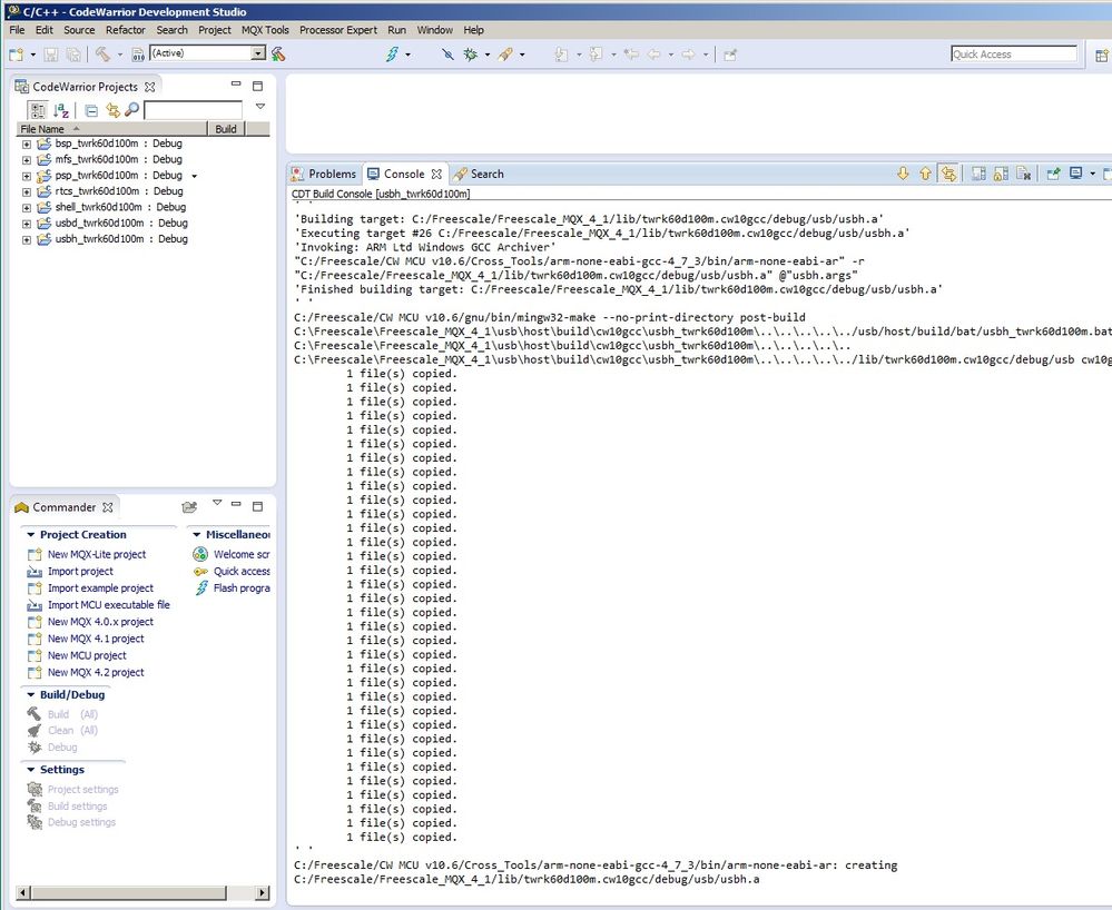

I tried  to build library for TWRK64 board, based on MQX4.1, when I imported build_libs.wsd I got the message with  two warninngs (attachement TWRK64warnings.jpg).
After build, I got a lot of errors (TWRK64errors.jpg and TWRK64errors1.jpg). Could someone explain, where I made an error, since I only imported finished project.

I haven't modified the libraries. I uninstalled the MQX4.1 (and MQX4.1 for TWRK64) before and installed again.
I build the library for TWRK60 on MQX4.1 - result: no errors. see pictures.TWRK60d100m.jpg
The only difference is that the TWRK64 library for MQX4.1 is installed additionally  as separate MQX4.1 package.
