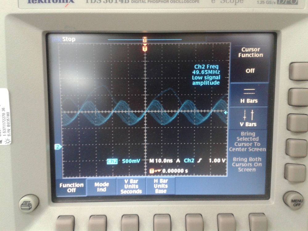

It seems to be a hardware problem:
When you power up all Tower System from TWR-K60D100M's J17 connector (OJTAG), you can see that clock signal has some distortion on it (Primary Elevator on pin B24):
this does not happen when you use TWR-SER board.

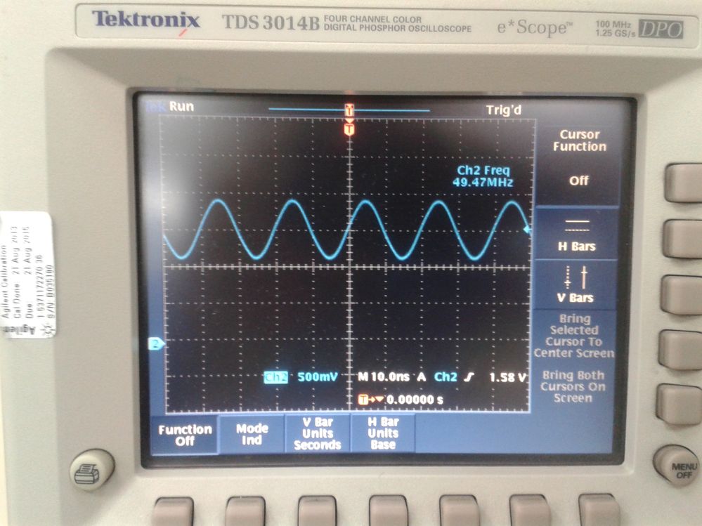

However, if you power up all Tower System from Primary USB connector (J5) you can ensure that clock signal is cleaner:
But due to Eth-to-serial demo uses UART from J17 connector ('ittyf:') you must connect also your USB cable on J17.
If you test using both connections (J17 on TWR-K60D100M and Powering System up in J5 from Primary Elevator) you would see that demo is working fine.
