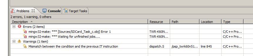

Hi Martin, I imported your demo into CW10.4 and MQX4.0.1 but I got the following errors:-

Hello Chee Boon Lim,
please always provide the console output (with an error, not entire text which can be long sometimes). Can you "decrypt" anything from the picture you attached? I definitely don't.

cheeboon
Hi Martin, BSPCFG_ENABLE_ESDHC is enabled in user_config.h. Attached is the console output. Thanks for looking into this.

Martin_
Hi, you don't have. This is the error message from the console output:
=#error This application requires BSPCFG_ENABLE_ESDHC defined non-zero in user_config.h. Please recompile libraries with this option.
Errors caused tool to abort.
mingw32-make: *** [Sources/SDCard_Task_c.obj] Error 1
>preprocessor #error directive
You have to build the BSP project first (as part of BSP library post build action, user_config.h is copied from the /mqx/source/bsp to the /lib). Then build the MQX application.

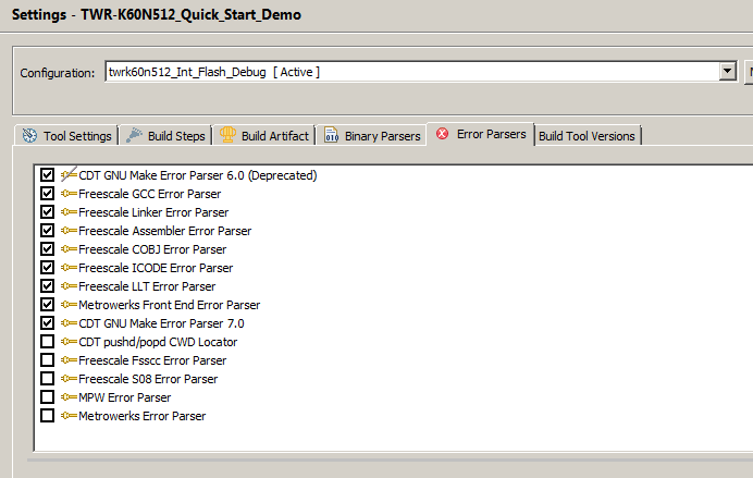

Hmm, the error messages are not very helpful. Since the compilation error is with the SDCard_Task.c, do you enable BSPCFG_ENABLE_ESDHC in your user_config.h ?
To get better error messages, please use the right error parser - that is configured in the options of your project, in C/C++Build -> Settings -> Error Parsers. Make sure that "CDT GNU Make Error Parser 7.0" checkbox is checked. Hope this helps to get more meaningfull error messages - see also the "Console" tab.
