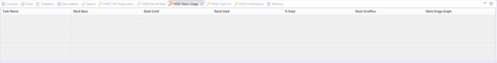

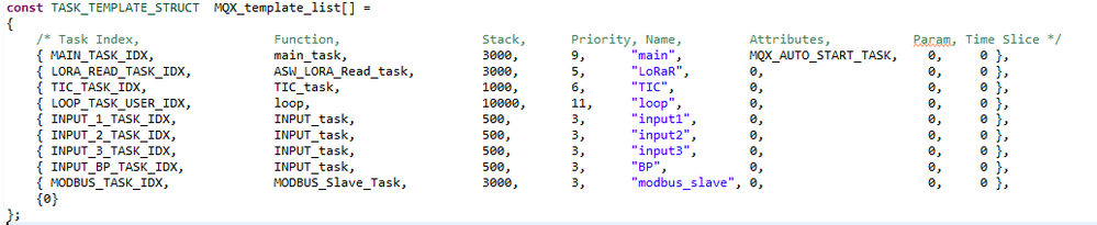

I'm facing a strange behaviour using TAD. I've tasks with different stack size :
Just after creating the "LOOP_TASK_USER_IDX" with _task_create(0,LOOP_TASK_USER_IDX,0);
I lost data from TAD. There is no error returned by _task_create()
All TAD tabs are empty. That's the last task I launch, and before it TAD is working fine.
This behaviour change according to LOOP_TASK_USER_IDX task size. If i reduce the stack, TAD works.
Untill this morning it was working with 10000; After i made some tests, it don't work with 10000; Only with smaller value (about 7000)
I dont' think i'm using all the RAM, BSS for my project is 6808 and total task Stack is 22000. MK21FN1M has 128KB of RAM,  according to RAM Memory Utilization ,even if I consider only the 64KB lower part I must still got a lot of memory

Does someone know what is hapening with TAD? Does the error came from TAD or must be in my code?
I join TAD logs
