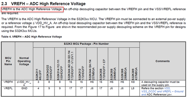

Senlent
Hi@dhanabharathi
I'm not sure what you mean. Shouldn't VREF be fixed? I
sn't it determined during hardware design?
If I'm misunderstanding your question, please let me know.

Senlent
Hi@dhanabharath
"My ADC reading seems to be calculated using the internal 2.5 V reference"
Unless there is a problem with your VREFH pins, this is not possible
The ADC reference voltage VREF cannot be modified via software.
This is related to your current external voltage selections for VREFH and VREFL pins.
If you are referring to how to modify the external ADC reference voltage in hardware, then you
need to review your hardware design and modify it.

Senlent
Hi@dhanabharathi
vrefh and vrefl are the high and low reference voltage points of the ADC, corresponding to the vrefh and vrefl pins of the pins
Can you understand my explanation?

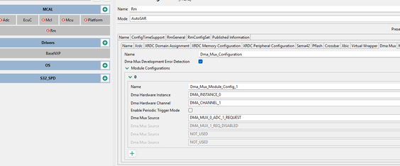

Senlent
Hi@dhanabharathi
You didn't add and configurate "Rm" component in your project.
