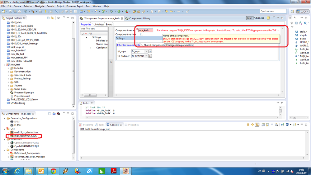

1) Firstly I tried to use the MQX_KSDK component but with the error message as follows:

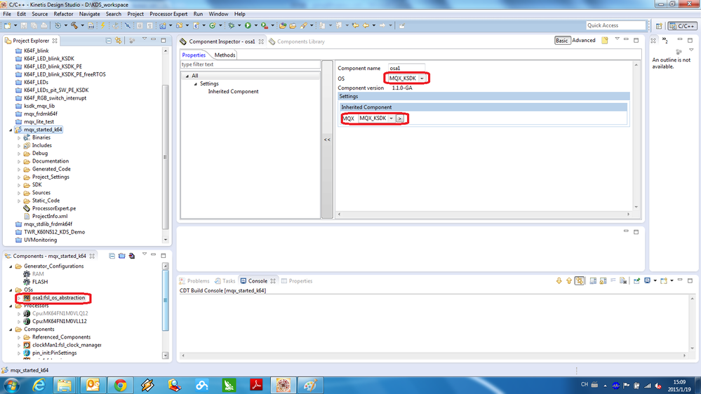

2) After reading through some of the posts, I just removed the MQX_KSDK component from the project and keep only the osa component as follows and changed the OS type to MQX_KSDK.

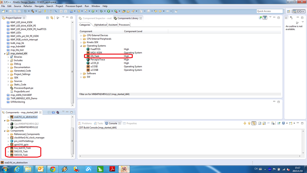

I then used the OS_Task component to create three tasks.
The first task "live_led" is to blink the red LED on FRDM-K64F, it actually worked fine.
The second task is to make the green LED on when SW2 is pressed, the third task is to make the blue LED on when SW3 is pressed. But after adding the SW2 and SW3 tasks, the project can be compiled but does not work any more. I could not find out why.

Hi I imported and compiled your example mqx_started_k64.zip
(Very useful to have a working example for PE+KDS+MQX)
After running it and notice that the first task gets stuck the first time that executes  OSA_TimeDelay(100); I played a bit and
discovered that if you put the three task at the same priority (8 in my tests) it will work as expected;
maybe it' s worth to give a try.
It seems that a different priority of the tasks causes the trouble (you tasks where at priority 8, 9 and 32)
(test performed using KDS2.0  and SDK1,1)
