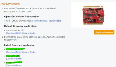

HI,
When plugging in the TWRK65F180M board, the MCU does not turn on. Only when I press the reset button does the D3 LCD start flashing. My computer then recognizes it as a device, pulls out the cperacceirosca vi olo ma po 10 seconds until the computer no longer recognizes it as a device The LCD of the D3 keeps flashing even though the MCU is not recognized by the computer.
To fix this, try these steps:
- Press and hold the RESET button (SW1).
- Connect the mini-USB port (J7) to power the board which should be numbered as a BOOTLOADER volume.
- Drag and drop the attached J-Link binary.
-Disconnect and connect the USB cable.
Then LEDs D3 and D5 light up but an MBED window opens and the MiniUSB port is not recognised. What can I do to fix the problem? Do I have to copy inside some specific file (es: file.bin) ??

Hello, my name is Pavel, and I will be supporting your case, I revie your information and what's is the IDE are you trying to use?
On this page, you can find 3 different .bin. OpenSDA Serial and Debug Adapter | NXP Semiconductors

I have solved it.
I load into the board the DEBUG_OpenSDA_for_MBED_Bootloader_by_Pemicro_v108_v2.0.bin file  for bootloader upload (download from the PEmicro website). Now the board run perfetcly!
Thank you Pavel for your support!
