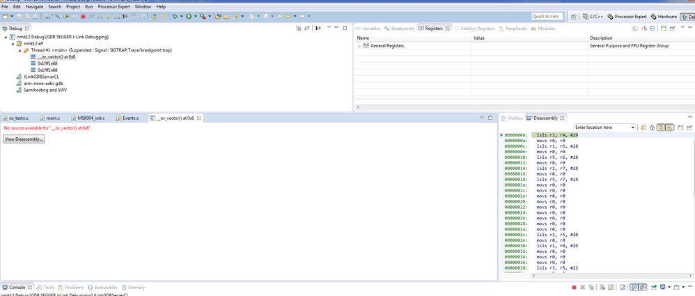

My debugger gives out "__ isr_vector () to at 0x8"

I used  KSDK + FlexCAN + MQX.
I used interrupt and RxFIFO
1) How to solve this problem?
2) Where it is possible to follow an example of source codes  KSDK + FlexCAN + interrupt ?

You can find an flexcan irq example at the path: C:\Freescale\KSDK_1.3.0\examples\twrk64f120m\driver_examples\flexcan\flexcan_loopback
In order to create a new MQX for KSDK project, please follow the below document,
How To: Create a New MQX RTOS for KSDK Project in KDS
After that, copy and paste the flexcan code under a task in the new MQX project.
I hope this helps,
Sol

I used processor expert.
And when i send to my bord message for FlexCAN, my debuger gives out    "__ isr_vector () to at 0x8".
I use PE+MQX+KSDK+FlexCAN.
I attach the project
https://community.freescale.com/servlet/JiveServlet/download/590064-367761/nmk12.7z.zip
