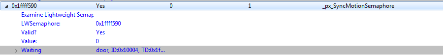

My semaphore is a global variablepastedImage_3.png and initialized is my init_task.

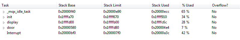

There is no task in overflow.
Is is valid when the ISR occurs.

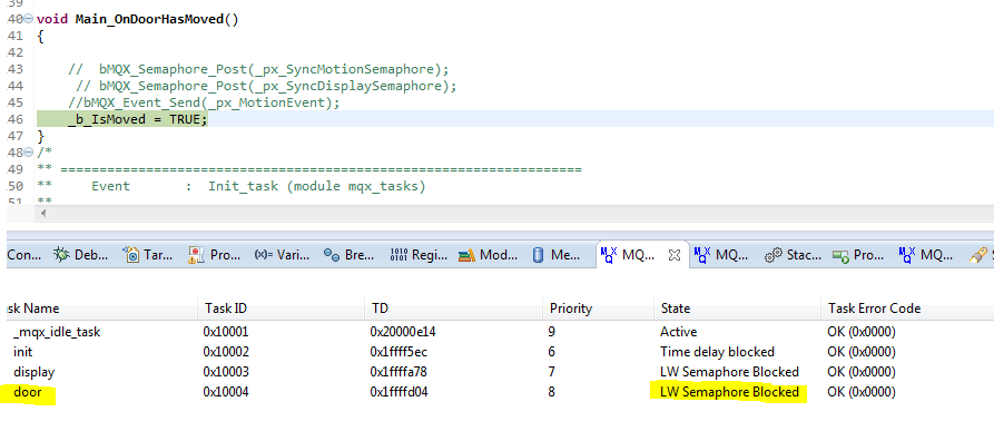

My task I called  "Door" is waiting for the semaphore.
And all the enabled ISRs would be initialized. I have removed the semaphore and replaced it by a simple variable (_b_IsMoved) and it works. But it is not memory safe when you deal with several threads....
I also tried the semaphore out of the ISR, and it works. So my issue is probably ISR dependent.
