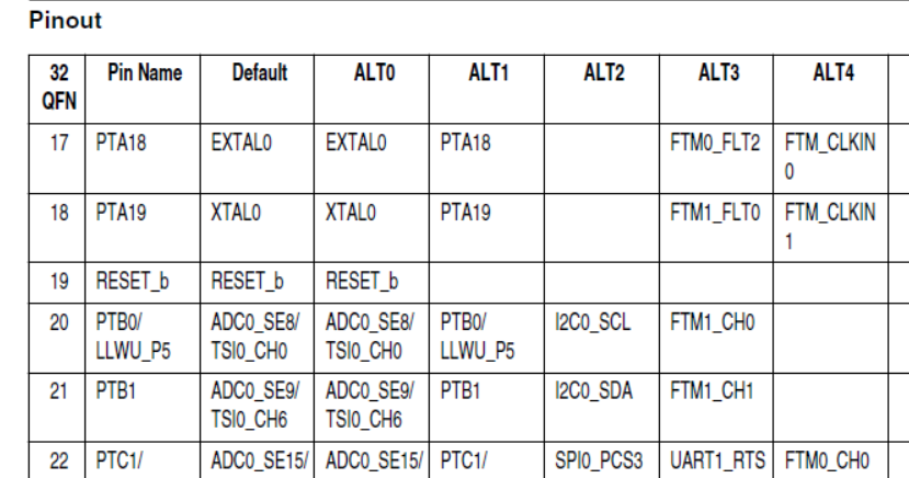

In k20d50m BSP for MQX4.1, the I2C0 pin config is done as below in init_gpio.c. There pctl->PCR[2] and pctl->PCR[3] are used to configure SCL and SDA for I2C0. It looks like it uses pin PTB2 and PTB3 instead of PTB0 and PTB1 as stated in K20P32M50SF0RM shown as snapshot below.
So question is, which PTB pins are correct?

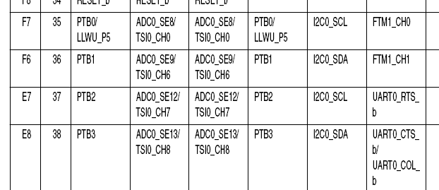

danielchen
K20D50m BSP is for TWR-K20D50M board, if you are using other MCU,  you need to modify the BSP according to your requirements
1,315 Views
danielchen
Hi Hui
Please refer to K20P64M50SF0, PTB2/PTB3 is right, PTB0/PTB1 also right. K20P64 is on K20D50M

huishao2
Hi Daniel
Looks like we are not using same document. I am using the one for MK20DX128VFM5 that doesn't have PTB2 and PTB3. So I assume this is a bug I need modify the code in _mqx_int _bsp_i2c_io_init() for this model.
Thanks!
Hui
