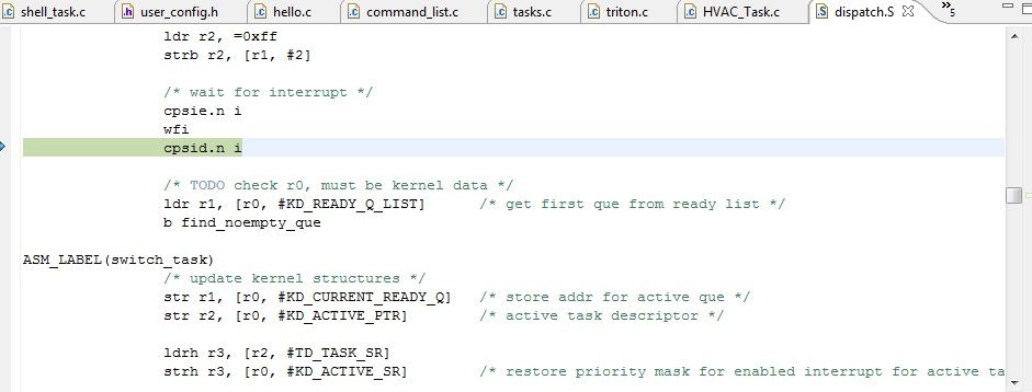

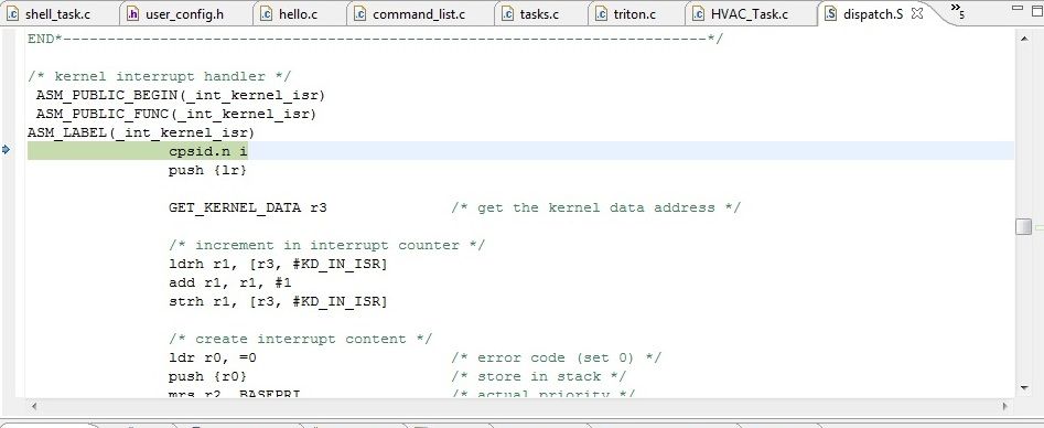

Hello All,
I have almost a similar issue so I want to discuss it here. I developed a MQX application on TWR-K60N512 evaluation board. The chip on the tower is a PK60N512VMD100. When I use the tower everything is good.
When I switch to the custom board with the exactl same bsp and app code I have a problem. I didn't clone the bsp. I just use the original one because we didn't change any hardware so far. The same clock rate. the same io pins.
The problem is we I try debug the code  and press debug button it stucks in dispatch.S (see the below figure)
and when I press it again it stucks in another line and stays there forever (bellow)
it a bit weird because I use exactly the same code and bsp that I use for twrk60!
I did add RTC battery and disable RTC didn't help. I changed the debugger to start at program entry point no difference!!
So I wonder if anybody out there have had the same issue and can give me some hints.

ee_dugan
If I remember right, that's the difference - PK60N512VMD100 vs. MK60DN512VND10.  If you look at the datasheets, there are differences so you cannot use the same BSP.  I forget what the differences are though.  We had to link the correct MK60DN512VND10 files instead of the PK60N512VMD100 files into the BSP.
6,250 Views
anthony_huereca
That was going to be my response too. The TWR-K60N512 board has a MK60DN512ZVMD10 part, which is Rev 1.x. The MK60DN512VMD10 part is a 2.x part. This app note describes the differences, and so you need to use the TWR-K60D100M BSP then on your part.
6,307 Views
FarhanH
Try opening your bsp and disable the RTC in processor expert. Also set BSPCFG_ENABLE_RTCDEV in user_config.h to 0. Re-generate the code, compile and try it again.
