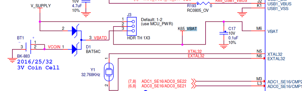

danielchen
Hi Jesper:
This seems a hardware issue. Yes, RTC is powered by VBAT, there maybe problem with reading the RTC registers when VBAT is not fully charged. I suggest you check your schematics for VBAT, please refer to the below picture. I assume you are using K65F180 chip.

jesperevertsson
Hello Daniel, we are using our custom hardware and we understand that the problem is caused by the hardware design. We also know ways we could fix it in the hardware, but we already have products that we've sold to customers and ideally we would be able to do a small adjustment in the bsp_cm.c file that prevents them from experiencing this bug.
If there is no way to get the status of the VBAT before trying to access the RTC registers would there be an easy way to just add a small time delay in the code before the RTC registers are accessed?
