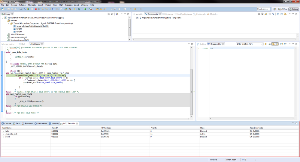

peterfurey
Hi Iva,
I'm using KDS 3.0.0, KSDK 1.2.0, and have the latest TAD installed (1.0.8.201504151538) but I am also having this same problem.
Nothing is showing up in the TAD windows. For example the MQX Task List tab shows "Task list not retrieved successfully" in the Task Name column. Any idea what the issue might be?
Peter
....Just discovered that these fields only show up after I hit the pause button..., progress...
2,160 Views
ivadorazinova
Hello and ,
if you want to see the MQX Task List, you should suspend it by the button
then you will see in MQX Task List
Please, does it help you?
Iva

peterfurey
Hi Iva, Yes I figured this out yesterday. Thank you for your follow up. Peter

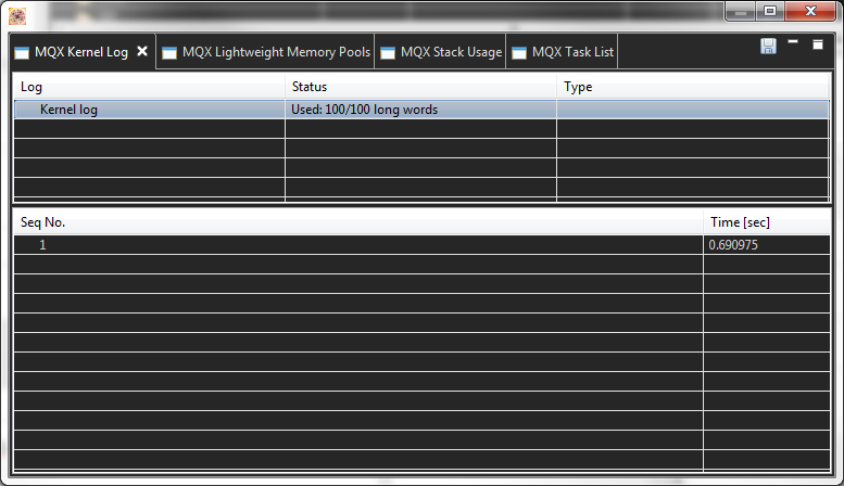

leifzars
Okay, looks like 1.0.8 fixed the issue.
But I found one issue, the Kernel Log tab only shows one log entry. It shows the Log, then only the first log entry in it.

leifzars
So in CW I would see all 100 log entry's when viewing the kernel log. I have my log size set to 100. In KDS 3.0.0 MQX lite 1.1.1 I see only one log entry.

leifzars
Do you see the problem ?

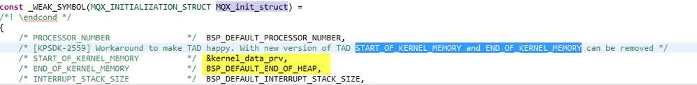

DavidS
Hi Leif,
Things to try:
- Re: Problem: Installing MQX RTOS Task Aware Debugger for GDB plug-in (TAD)
According to this the MQX_init_struct should contain fake items for START_OF_KERNEL_MEMORY and END_OF_KERNEL_MEMORY.In the MQX examples the structure looks like this:
Try to comment out the START_OF_KERNEL_MEMORY and END_OF_KERNEL_MEMORY with #if (1) and #endif.
David
2,160 Views
leifzars
I have already install the MQX plugin, I am not sure how I can remove it and then re add it. I don't know how to remove a plugin in eclipse.
In MQX1.c kernel_data_prv is undeclared, so I get an error. But _mqx_kernel_data_struct is i think the same thing, so i made the substitution for __KERNEL_DATA_START.
/* START OF KERNEL MEMORY           */ &_mqx_kernel_data_struct,
/* END OF KERNEL MEMORY             */  (pointer)((uchar_ptr)&_mqx_kernel_data_struct + sizeof(_mqx_kernel_data_struct)),
No change.
