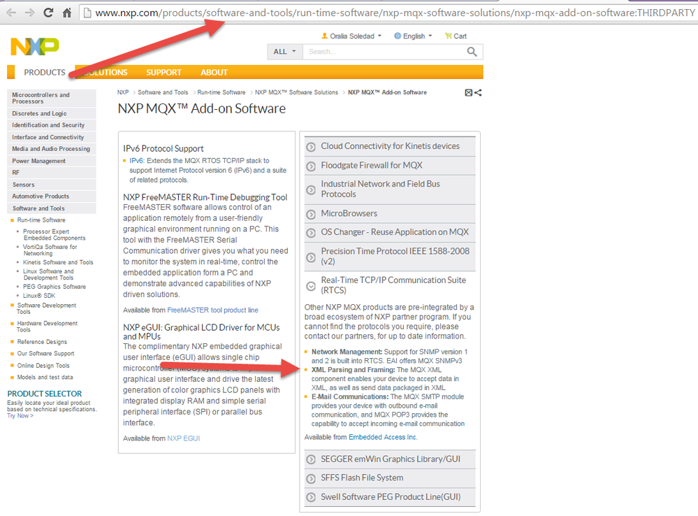

soledad
Hello Nitin,
XML is supported by a third party and it has an extra cost.
Sol
