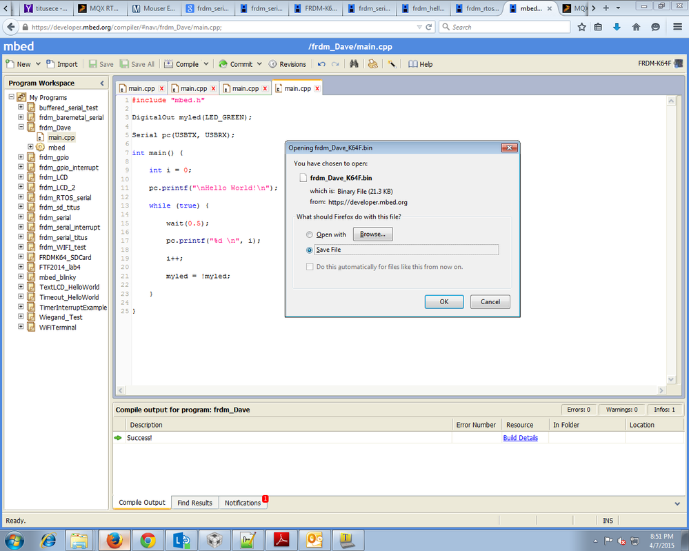

Hi David,
Thanks for your support so far.
I've tried already with newly created MBED setup and asked m colleague to try and nothing worked out. :-(
One last help :-)
Could you build and generate binary for the following MQX RTOS application.
Actually, I'm using the project based on the RTCS SHELL app on KDS IDE.
C:\Freescale\Freescale_MQX_4_1\rtcs\examples\shell\build\kds\rtcs_shell_frdmk64f
1,904 Views

DavidS
Hi Titus,
Are you sure you have updated the MBED firmware on the frdm-k64f?
I'm attaching what I have installed recently with fingers and toes crossed.
Out of other ideas.  Might sprinkle Holy water on it or try slamming it on the desk ;-)
I'm also attaching pictures of my FRDM-K64F front and back for you to compare against.
David

DavidS
Hi Titus,
One last attempt before I scream for help as well.
First I included the firmware again just to be sure you tried it since we've had many posts I thought the other one might have been missed.
Second did the pictures reveal any differences?
Back to the question at hand.  Is the only issue not seeing the terminal output?
If yes, what terminal utility are you using?
Lastly the boards as cheap so I wouldn't recommend trying to replace the MCU since the board might be the issue anyways.
David

titusstalin
Contributor V
I have followed the same procedure and able to download the binary automatically but that generated binary is not working.
What is going on ? :-)
