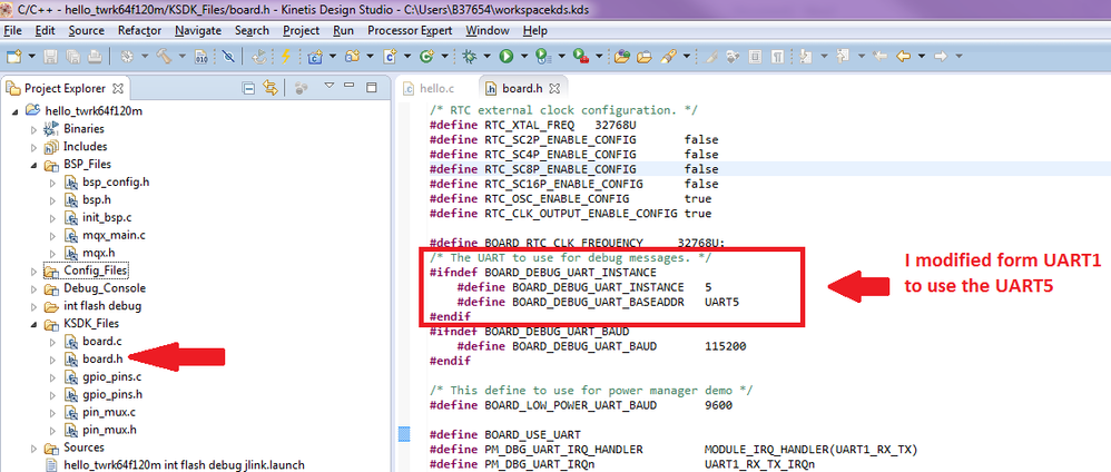

For example if you debug the hello MQX for KSDK example (C:\Freescale\KSDK_1.2.0\rtos\mqx\mqx\examples\hello\build\kds), the default console is the UART1 (OpenSDA - USB mini connector). However you can change it in the board.h file  please check the below image.
If you use PE you can select the UART that you need.

I have the UART I need selected. What I am trying to do is have two UART serial ports configured at once. One for diagnostics output, and one for communication with other modules that will be connected to the micro. I wanted to be able to use fopen and fread with both of those ports and was having difficulty with it. I have solved one of the problems but am still encountering others. I'll explain what I've done first.
I have the debug output configured to UART0 in board.h as you have said. I have then added these definitions to the "User settings" section of the MQX PEX component to start configuring my second communication channel:
