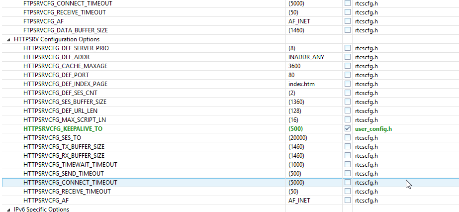

Other weird thing I noted is that the HTTPSRVCFG_KEEPALIVE_ENABLED option does not appear in the Codewarrior view of the user_config.h file. I needed to add it manually to the user_config.h file, after the MCT generated code comment (otherwise it gets removed every time I change some config and recompile RTCS, as it should be). It would be nice to have the option in the CW user_config.h view. Below the print of the view without the option mentioned.
