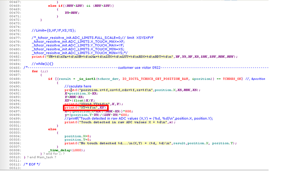

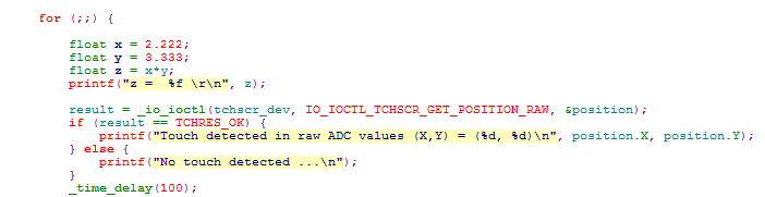

I'm using MQX 4.0 to develop touch driver, i wanna print float out but i can't do it.
i have already define XY to float.

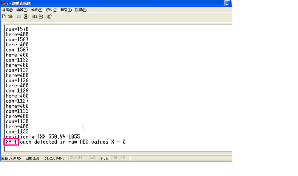

But when i write the function printf("XY=%f\n",XY);
it do not print float out!
it print XY=f instead.
Please help me on this question why it won't print float out for me?

Hi Victor:
I think you need to check your MCU supports floating point.
If it supports, the following steps need to be done to support float point

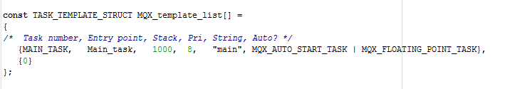

1  the task, which will use floating point, should be use attribute; MQX_FLOATING_POINT_TASK attribute, please refer to the below code snippet:
2  in user_config.h of bsp project, MQX_INCLUDE_FLOATING_POINT_IO should be defined as 1, and rebuild the bsp and psp project

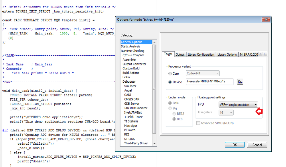

3  set the vfpv4  in IDE ,  if you use IAR, please see the below picture

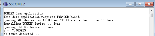

I did a quick test with the tchres_demo, it can work,  I added the following code for test
The output is :
Hope it helps

Sorry, i can't find vfpv4 on my develop environment ! Please see the
attachment.
I'm using Keil u Vision5 to develope!

2,323 Views
danielchen

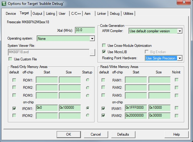

For Keil, please check the floating point hardware at Target tab
2,323 Views
wangtsungli
Thank you! I have solved my problem!
