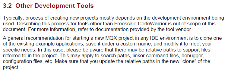

I'm running
CW 10.4
MQX 4.0.2
Target is TWRK60D100M
I've been able to build and run example projects and modify them a bit.
But when it comes to building my own project from scratch (or attempting to clone an example project), I'm running into trouble trying to figure out where all the needed pieces are.
The manual has this snippet:
Can anyone help me with that last line? "Make sure you update the relative paths" to what?! ___________________
Thanks in advance.
~LMG

Hi LMG,
Please try searching Freescale.com for AN3905 "Writing Your First MQX Application".  It is a bit dated but very educational.
Freescale MQX™ Software Solutions Product Summary Page
Also within CW10.4 you can use a wizard to create a new project by doing following:
File-->New-->MQX4.0 Project....   etc.
Lastly there is a wealth of educational information at following post:
https://community.freescale.com/message/350061#350061
David
