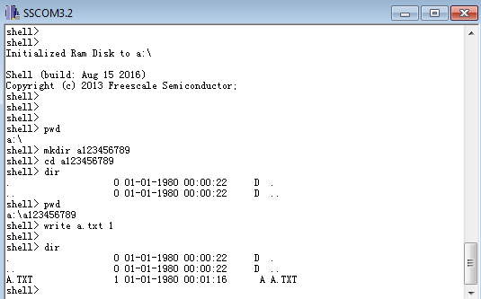

danielchen
Hi Luiz:
I tried  the shell demo with your commands on TWR-K64 borad, it can work in my side.
C:\Freescale\Freescale_MQX_4_2\rtcs\examples\shell
I remember that can't create directories whose name is more than 8 characters is a fixed issue in MQX 4.2.
2,447 Views
