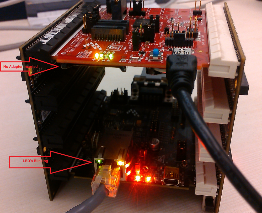

swapnilv
Hi David,
Configuraing it to UART3 worked and I can see the messages on terminal window now.
Thanks for your help !!
Regarding SD card issue for httpsrv example; I have not added code to interface to SD card and mount MFS.
I am just trying to run the httpsrv_twrk60d100m project as it is. I am using KSDK_1.1.0 and IAR workbench version 7.10.3.6932.
Below is snapshot of tower board along with TWR-SER board when SD card adapter is not inserted. Project works fine in this case and I can access the sample web pages using browser for assigned IP address to tower board.

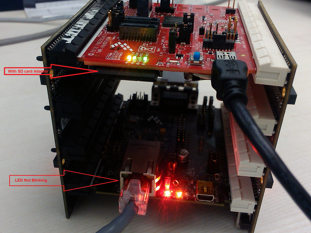

But when the SD card adapter is inserted then I am not able to access the pages on the assigned IP address  tower board.
You can see the LED's at LAN connector have stopped blinking when the adapter is inserted.
What could be the reason for this?
Swapnil
