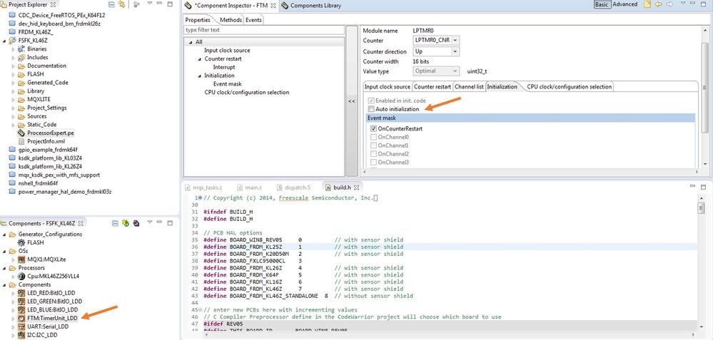

I have added a solution for this issue:
  • Disable LPTMR's auto initialization
  • Save changes and generate code.

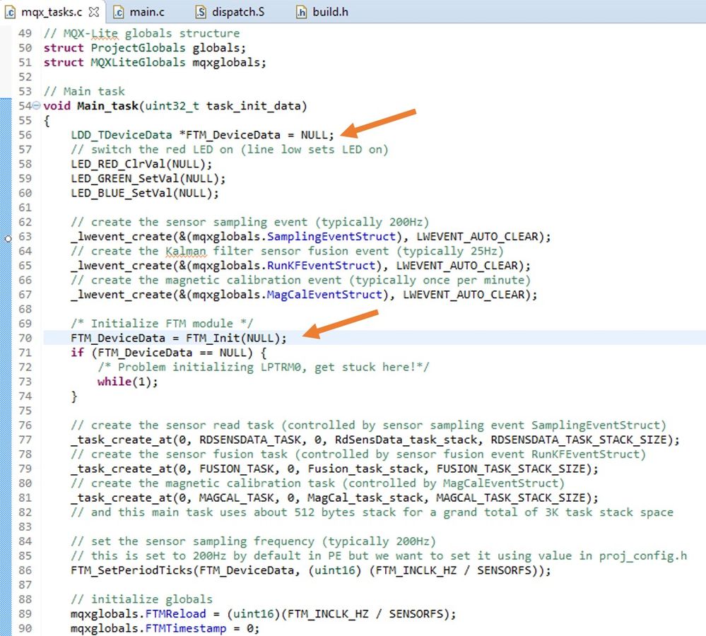

  • Go to mqx_tasks.c and modify main_task in order to initialize FTM module once MQX has started:
  • Save changes, compile the code and download in your board. It should work now.

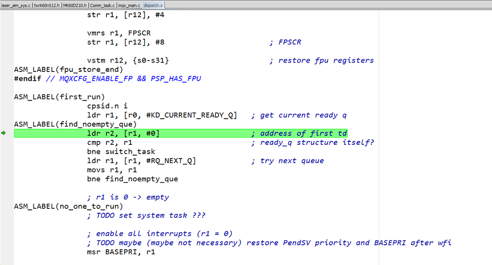

                    I try to clear the LPTMR0_CSR register in my BSP files,but I found  my BSP files have no files to set the LPTMER0 except the MK60DZ10.h  ,but  the file just  define the  macro  to set the rigister.
                   So I just describe my situation,my board is stuck in the dispatch.s file after the reset  trigered by the WATCHDOG interrupt,  except for Power-On Reset as you say. if I don't reboot it with shutdown the watchdog, the board works well .By the way ,I have made over 20 pcs boards with the same hardware ,most of them works well ,just 5 of them have this problem.  I have referred to other way the solve  this problem just like disable the RTC clock  in the userconfig.h and the   bsp_cm.c &bsp_cm .h  files ,but nothing helped .I post the pics just where the programes run stoped .
  hope for your suggestion,isaacavila!
