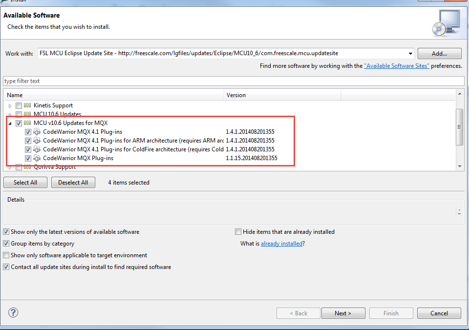

Hi Leonardo,
please make sure you installed CW10.6 updates for MQX
please see this document for how to porting CW10.6 MQX project to kds
Importing MCU V10.6 projects (sample, using PE and MQX) under KDS

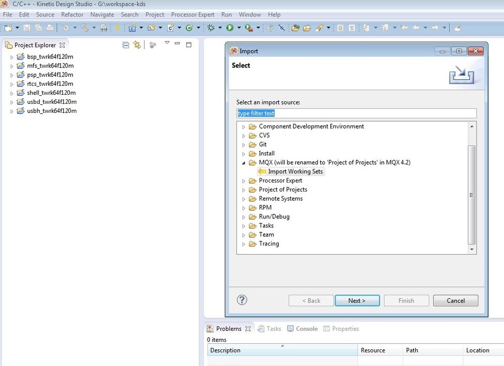

Hi Leonardo
I attached a picture to show the MQX libraries in KDS 2.0
892 Views
DavidS
Mqx_4.1.1 has support for kds_2.0.0.
I have used it successfully.
