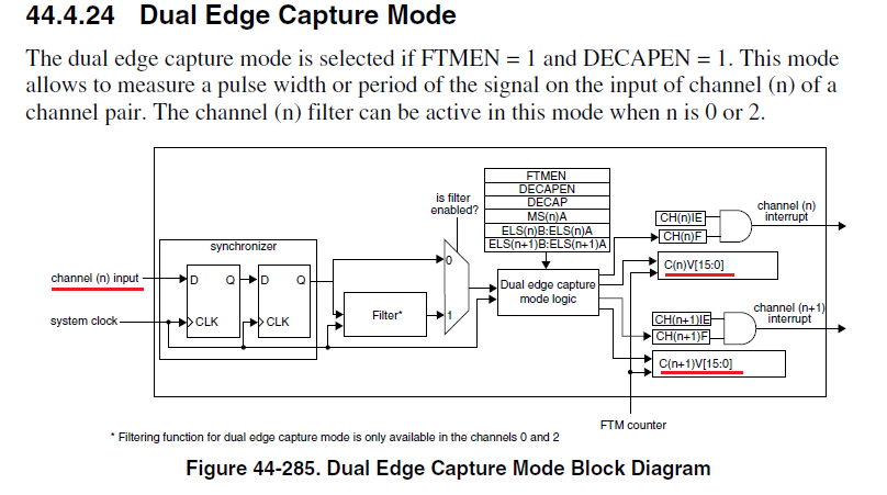

danielchen
Please see the below picture, if input is CH0, then n=0 , you can get C(0)V[15:0] and C(1)V[15:0].  you have to apply your square wave signal on pin FTM_CH0.

arnogir
Senior Contributor II
Then I done the following correction:
-Don't use external PIN PTF20
-Initialisze MOD register to 0xFFFF, else counter stay at 0.
